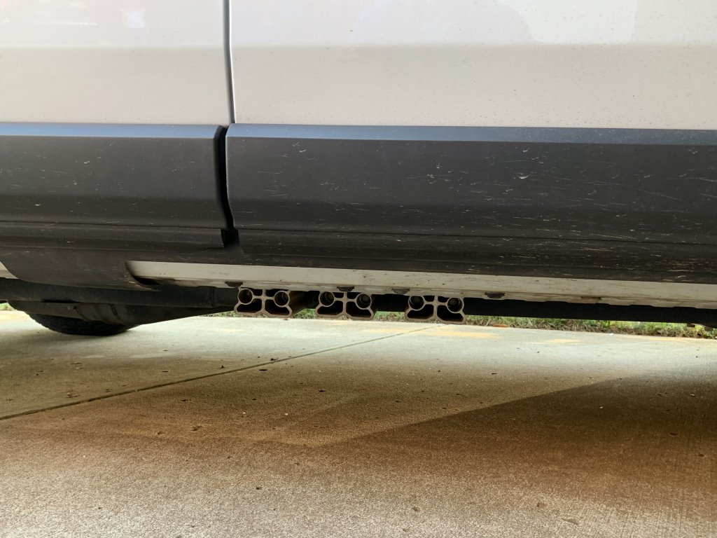

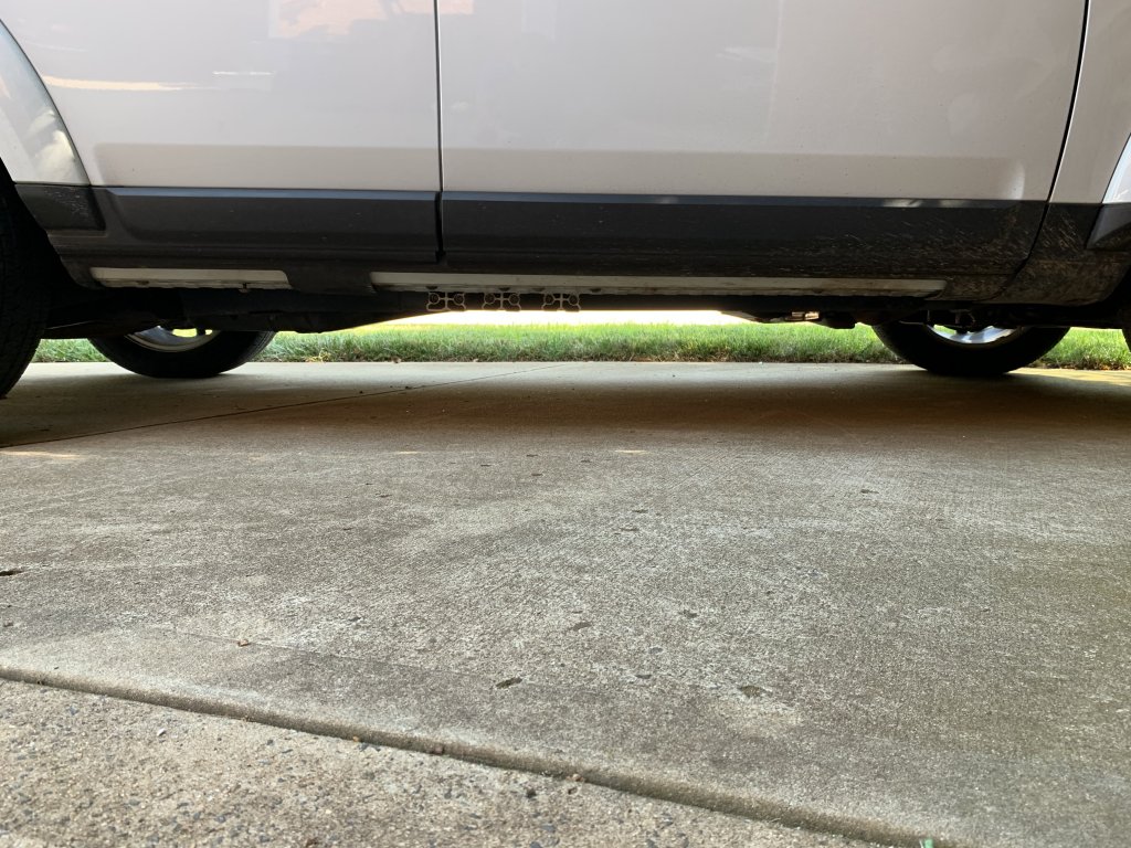

so I took them off today- I was surprised to find that the black plastic trim has big cutaways exposing the white paint... anyone know where I can find replacements from non runningboard models?
Also, what are the 3 aluminum blocks under there???

The aluminum blocks are spacers for mounting. They are bolted on. You can remove them. You may have to clean out the bolt heads in order to get the wrench to fit.
1,860
The aluminum blocks are crush sleeves for side impact. They are part of the running-board system that became standard on all US-spec LR4s in around 2014. If you've removed your running boards, you don't need them anymore.

any thoughts on where to find the plastic trim to cover the rocker area?
blacktie
Sep 16, 2014
29
yeah- That is on my long term list....
for now I would like to just cover it up
