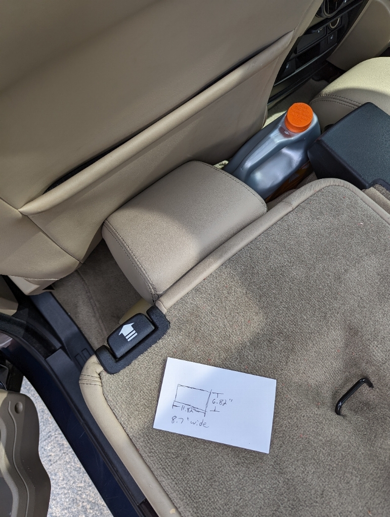

I'm looking to stow a lithium battery pack and the perfect spot would be right under the headrest illustrated below. Its a pack of 4 of the cells pictured EVE LF280K 3.2V LiFePO4. I pulled on the headrest and it has a stop in there. On my last car they came out. On the LR4, can they be removed?
1,860
There's an additional hidden button on the plastic trim that surrounds the headrest posts. It's not the same button you use to raise or lower the headrests.

I tried pressing it, maybe I need to use a screw driver to push it in further. I didn't want to break it since it is a fragile plastic piece.

Agreed, they have push in buttons on both posts, quite stiff. You need to push both in at the same time and then lever the headrest upwards, it can be a trick...
