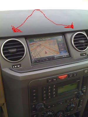

I'm a little confused
so the center vents hold the dash in? and pull from the bottom?
see below

You can grip the sides or the vents. It is just a bunch of clips (about 6) that will pop loose. One set of clips is up near the vents another set about mid way down and a set at the bottom.
Some like to start towards the bottom so if you grab down toward the climate controls and pull out the lower clips will start to release.
Just give it a tug it will come out.
