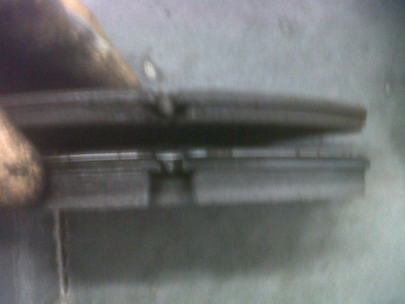

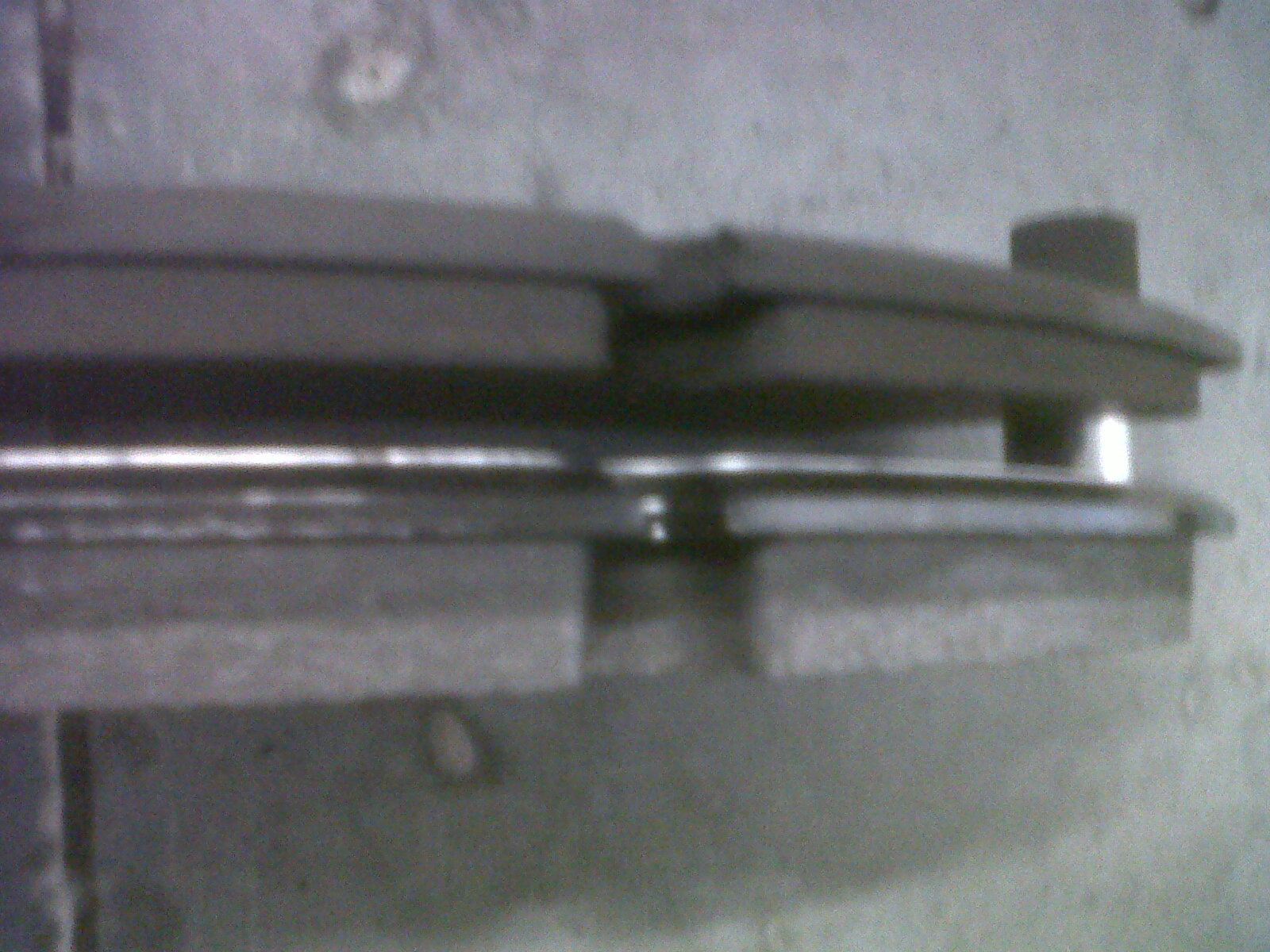

Our LR4 has 39,897 on the odometer, and I just replaced the front pads for the first time since new. We bought the car May 31, 2011 with 12 miles on it, and it is our dailly commute vehicle between Salt Lake City and Park City, UT.
I keep hearing stories of excessive front pad wear, but I did not experience it. I have attached two pics: 1) outer pad (top) versus the new pad (bottom), and 2) inner pad (top) versus the new pad (bottom). (Sorry - cell phone pics). We hadn't tripped the pad sensor, but the pedal was starting to get a bit "spongy".
The DIY was real easy - no different than on the LR3. I used an 10" C-clamp (Home Depot) and a block of wood to push back the dual pistons. That took some finesse. To remove the bolts to take off the calipers, I used a 13mm ratchet, and held the corresponding nut in place with a 15mm wrench. Other than that, not bad at all.... I was even able to re-use the pad sensor, saving $35!
Other things I learned:
*Land Rover has changed the SKU of the front brake pads as (supposedly) they have gone to a new compound. SKU #: LR032063G.
*Front OEM Pads (dealer price) = $187.22 + tax.
*Torque for Lugs (google search) = 103 ft-lbs.
We love our LR4!
