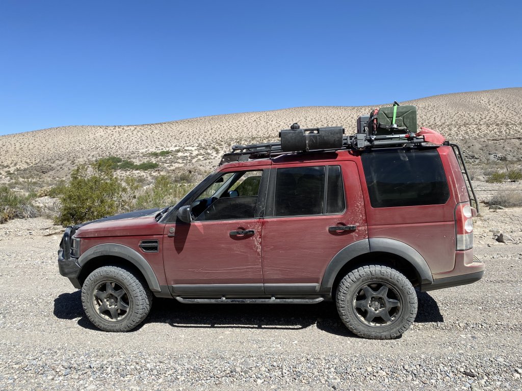

This may be what I’m experiencing on both my LR4’s after swapping to EBC rotors and Yellow Stuff pads. I noticed that they didn’t come with the EBC shims like the ones that my LR3 kit (with Green Stuff pads). Coming back from the same trip as CRYA (though I didn’t last as long due to a tire puncture (repaired it) and sidewall blow out (could t repair) and a lack of anything A/T for 19” wheels anywhere near Las Vegas) I experienced heavy pad chatter crossing the passes in Death Valley. Had to use more engine braking.

Your truck is a beauty. It took me a while but I was able to sell those OE black 19" wheels to offset the price of the Compos. Just sayin'. :)
