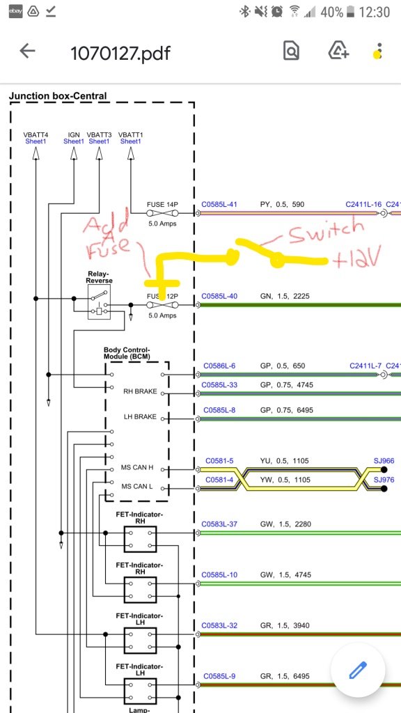

Been thinking of @Michael Gain suggestion, and might be overthinking this, but wanted to check.
If I simply popped an "add a fuse" into the fuse 12 slot and then wired the pigtail of the "add a fuse" to switched 12V, that should accomplish what I am trying to do, correct? Reverse lights would come on when factory switch activated, or would illuminate when switch on the "add a fuse" pigtail was activated.
I was originally thinking this would not be a good idea, because if I inadvertently left the "add a fuse" switch in the on position, and then shifted into reverse the circuit would then be fed with two +12V inputs at the same time. However, after getting home and relaxing with a beer, I'm thinking it wouldn't matter. The electrical potential of the circuit is the same, as both +12V inputs share the same electrical potential since they are being fed by the same battery and routed to the same ground.
Someone better at DC wiring take a look at the diagram below and chime in here. If both inputs to fuse 12 are "hot" at the same time, am I still at 12V and 5 amps to the reverse lights?
