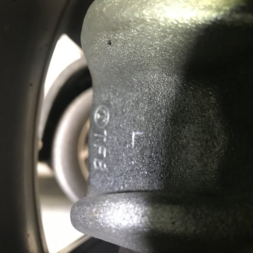

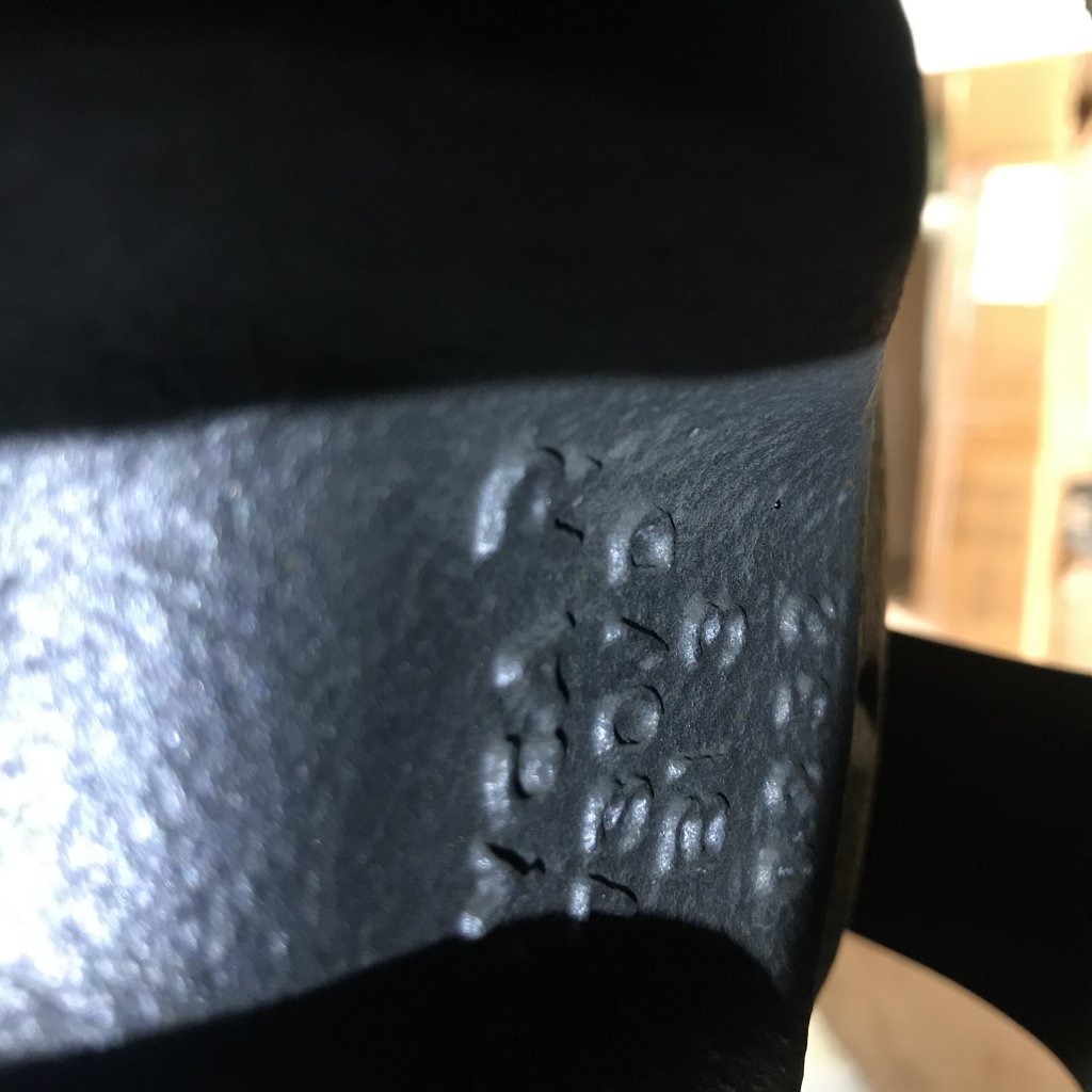

Here are pics from my front calipers. First pic front right, second is front left. They don’t seem to be the same.

I don't think it matters. The LR4 calipers are not high tech, just a simple single piston floating design. Keep the pins lubed with a silicone based brake grease or suffer the consequences when the pin bushings expand and cause the caliper to get "stuck"

correct, but the OP may have paid a significant premium for OEM parts.

You said they were warranty replacements. LR warranty?
Yes, I purchased the Land Rover extended warranty through the dealer, I believe it is serviced by assurant. I called the warranty company, they confirmed that they paid the price for NEW parts, ie $590+ for each front caliper and 250 or so for one rear. I paid for the other rear.
