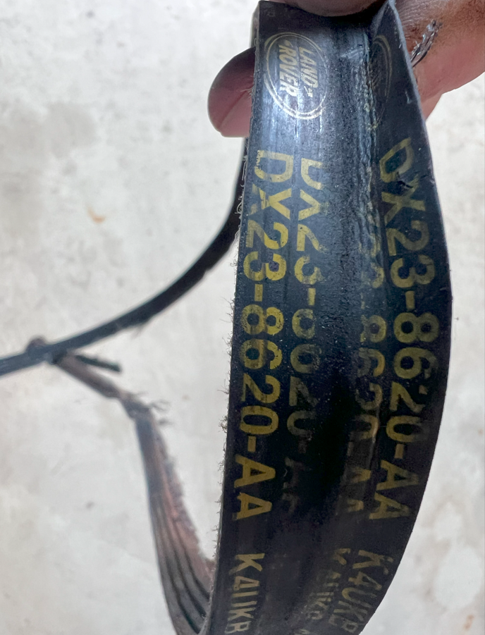

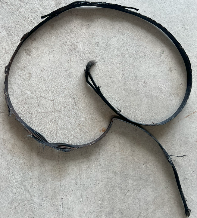

I did a little lunch time exploration, here's the belt (it was wrapped around the crank pulleys):

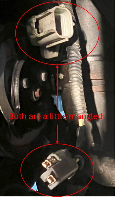

Which appears to have knocked out some temperature sensor just below the thermostat (this has the potential to leak coolant so need to watch this):

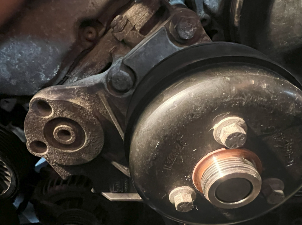

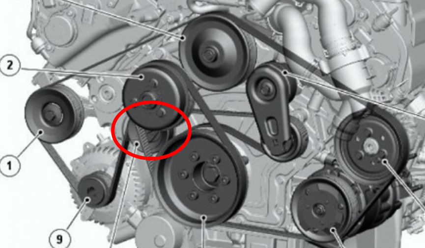

And the idler pulley that's supposed to be behind the viscous fan pulley is completely not secured and rattling around back there (like the shaft or something broke)! I'll see if I can get this out later on. This looks to be the root cause of the failure!
I'm also getting more convinced that there's been a slight leak, guessing the water pump based on evidence and location of the fluid.
