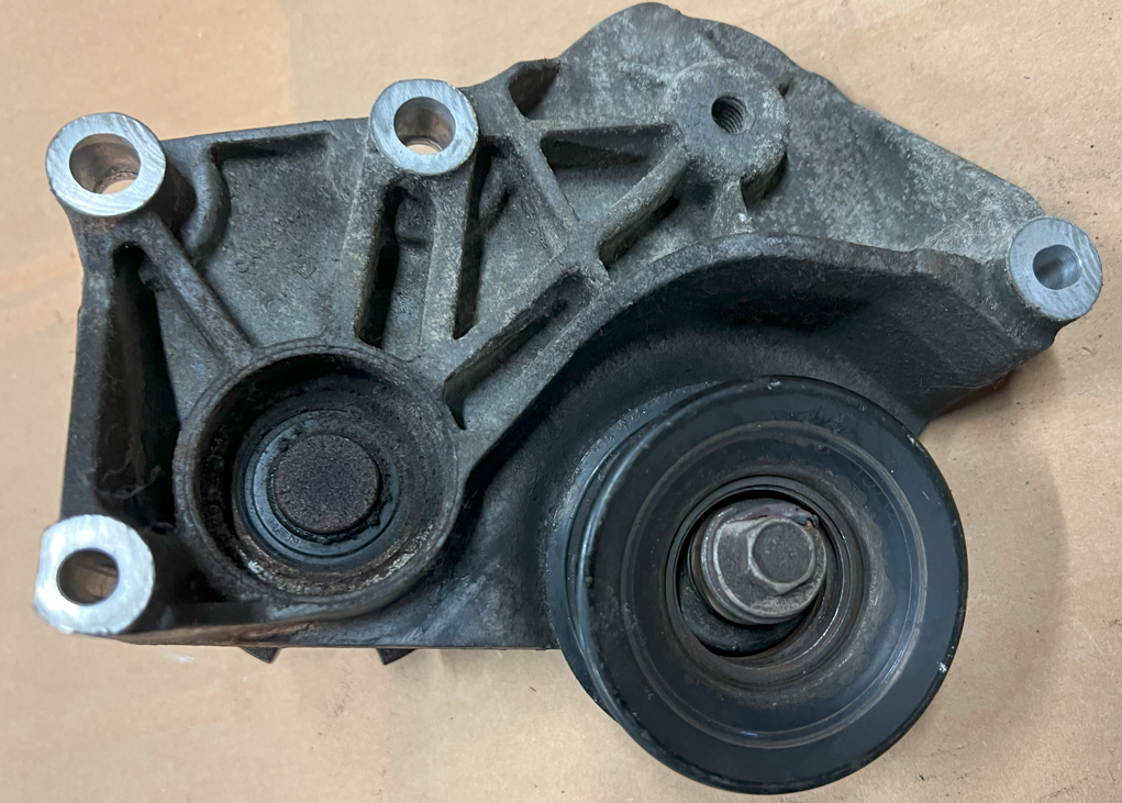

Agreed (esp. the bearings)! The pulley is actually back behind the bracket (who's part number I'm trying to find); I can feel the pulley rattling around when I stick my fingers back there. I believe I have to remove the viscous fan pulley to get access to a hidden bolt which will in turn allows me to remove the bracket and see what's happening; there are 4 bolts (25Nm) that hold on the bracket. There are 3 bolts holding on the pulley (also 25Nm). Will report back later.

Here's the root cause; it explains the bearings! This is the flat faced idler that sits behind the viscous fan pulley:
I'm now looking for:
- This idler (the bracket I think is OK)
- Bolt for the same idler
- The other idler (preventative - above the alternator)
- The pulley on the belt tensioner (has a slight nick)
- New serpentine belt
- New viscous fan pulley belt
- New viscous fan pulley (spotted a little damage on it)
Where do people shop? Lake Bluff seem quite reasonable; where possible I'd like to keep this OE. I also need to splice in a new electrical connector, does anyone know where I might find one of these (it's the connection below the thermostat by the alternator):

Likewise, I've bartered at the dealer but sometimes they won't budge... I'm in no hurry so I don't mind waiting for parts either! I typically don't have dealers work on my cars. I'll take my time and really clean up when I'm in there; this is not a luxury dealers typically have.
I didn't hear any telltale signs and agree with you that I should have. I keep reading that these engines are noisy so perhaps I missed it but there's not been any real obvious noises (screeches, grinding, etc.). I've long suspected the viscous fan is making the tick tick noise so that's on my radar, and the timing chains but right now that's very subtle, nothing like some of the YouTube videos I've watched.
