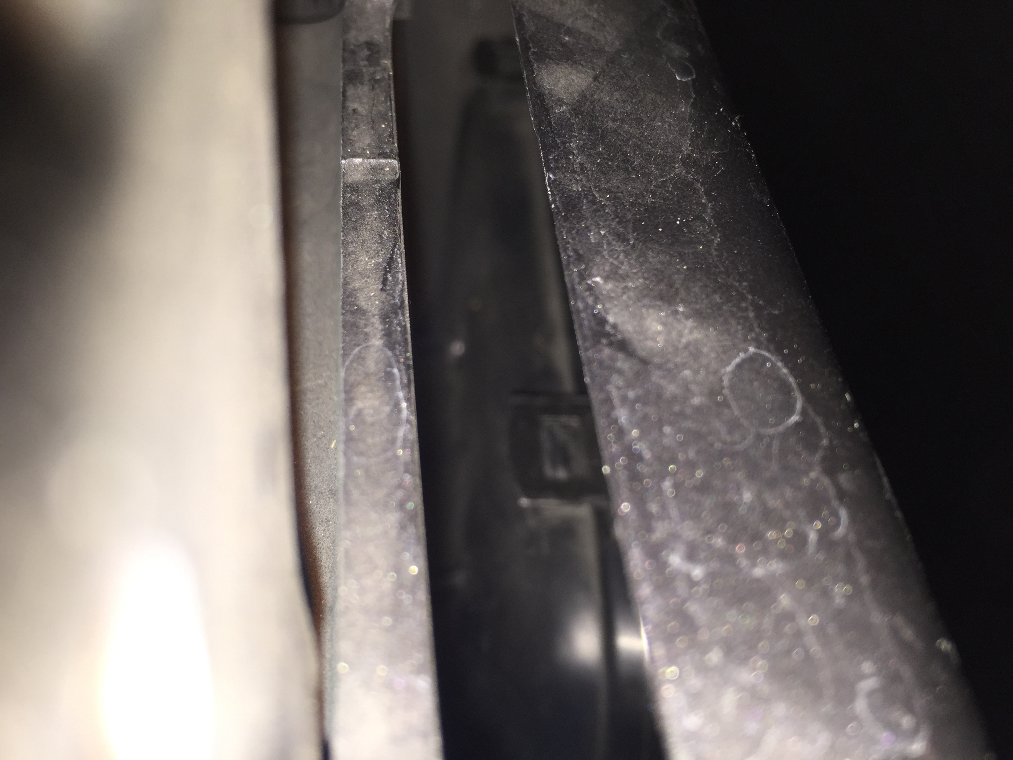

Hi all.
I have a 2012 LR4 and I'm blacking it out little by little.
I got a new set of black sidevents, and I can see how they are attached to the duct with 4 tabs.
The issue is I'm not sure how you actually get to the tabs when it's installed on the truck. The side vents are recessed in the metal, and there's no way I can see to get to them from inside the engine compartment.
I found some videos on how to replace them on an LR3 (basically just yanking them off), but I'd like to not break the original vents as I might use them later.
Anyone have a "how to" on getting these off?
Thanks!
pic attached...

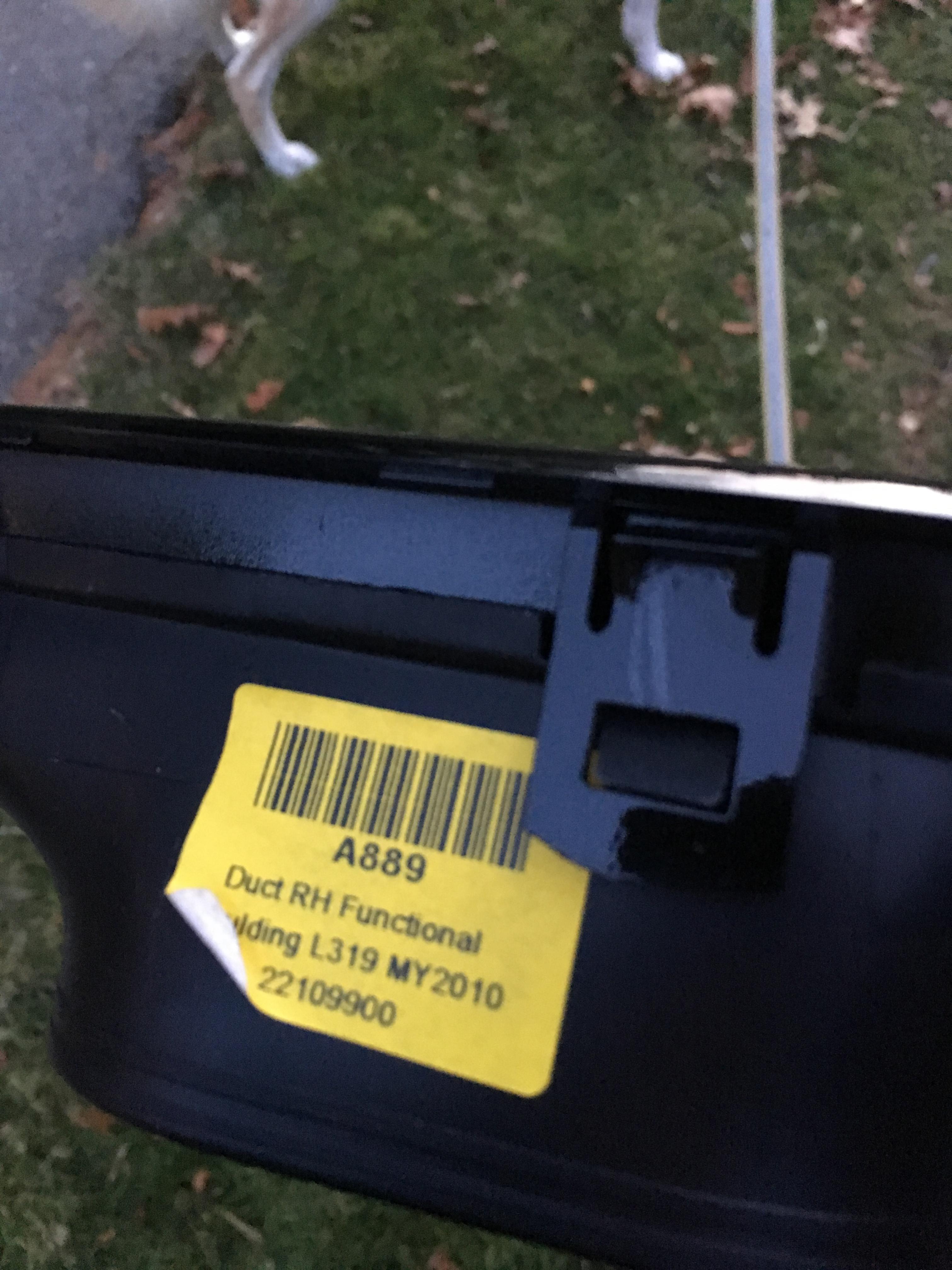

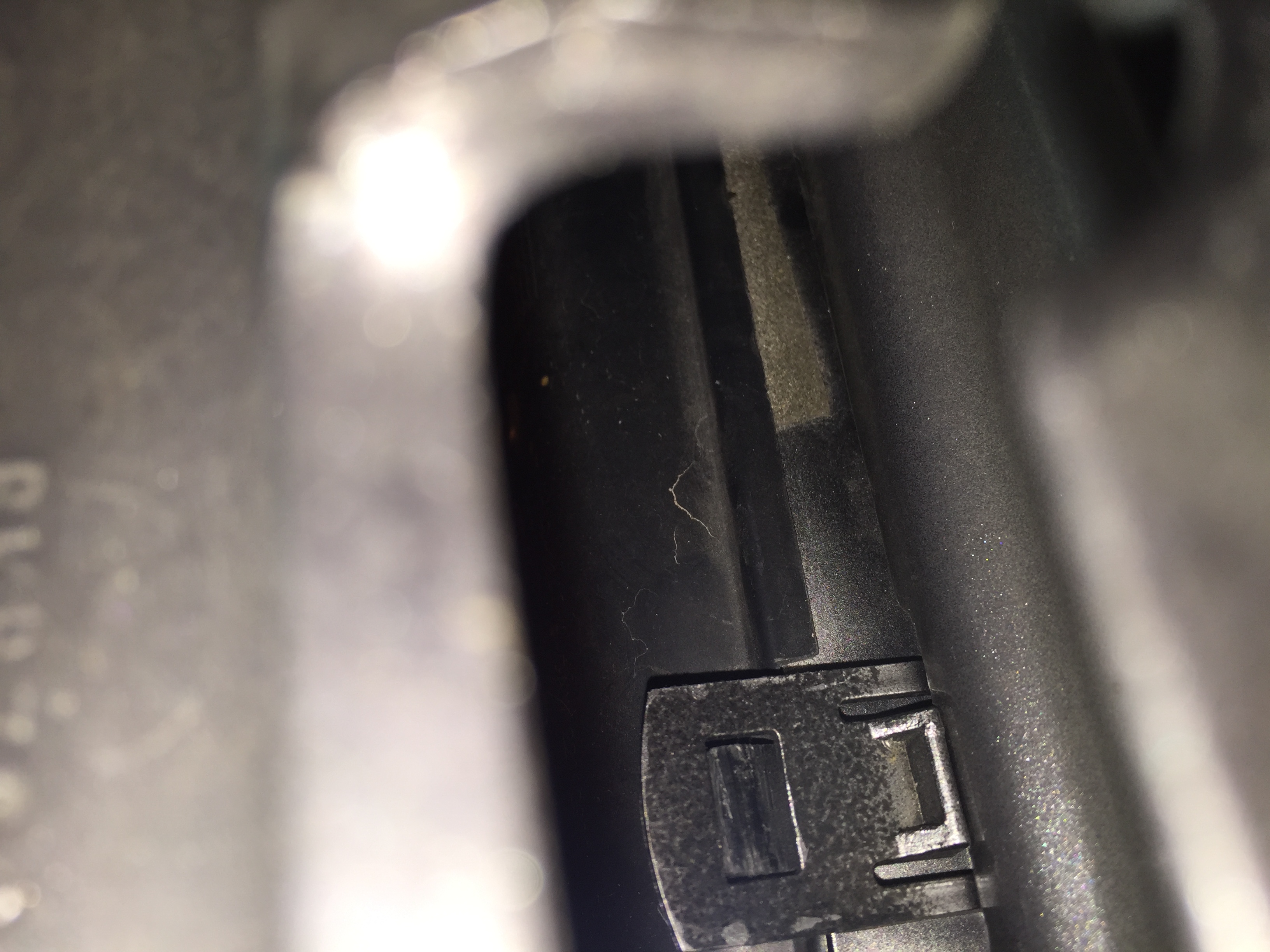

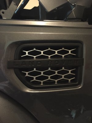

Sorry bout the pics, but today i had the chance to plastic dip my grill, wheels and side vents. I have the facelift version and after watching the LR3 vids i can tell you the tabs doesnt look the same. Theres two tabs on the top and two at the bottom.
It was just trial and error, i ended up using a long flat head to unclip the tabs from the gap within the bonnet. Just unclip the top tabs by pushing it down and pretty much after it is loose just give it a bit of a yank and it should pop out.
