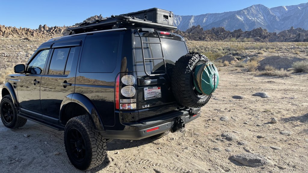

I'd strongly recommend considering the Terrafirma spare tire swing arm. I have the Voyager swing and it's not well designed or well made. Some examples of issues I've had:
  • The instructions include JPG files for the mounting templates, with no indication of scale which make them largely useless.
  • The swing arm is powder coated with no anti corrosion treatment on the underlying metal. Any chip in the powder coat will cause the arm to very easily rust (and continue rusting under the powder coat). See the other thread about Voyager for other examples of people having major problems with this.
  • The gas strut is underpowered to hold the weight of a 31"+ tyre. The strut also has no bearings or swivels for attaching to the arm. Instead, they just have it rotate on a bolt thread - very rough.

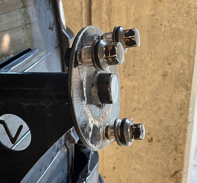

  • On mine, the three major studs used to mount the wheel weren't even welded perpendicular to the mounting face. This caused damage to my Compomotive wheels when I bolted them up. Voyager's response was to "hit the studs with a large hammer or block of wood".
  • Due to the way the wheel mounting face is welded to the main arm, you cannot make use of a bunch of standard spare wheel accessories available to the Jeep market, such as Rotopax mounts or bike carriers.
If I had my time over again, there's no way I'd buy the swing arm. It's backyard engineering at best.

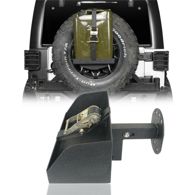

For a Jerry can you could use a universal spare tire mount Jerry can tray. A quick internet search found a few options. Do you REALLY need a hi-lift? Unless you’ve got steel bumpers and/or sliders you’ve got nowhere to lift the vehicle.

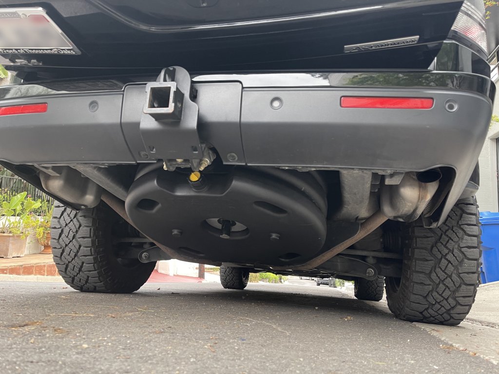

I just installed the Terrafirma swing arm and am using x2 Universal 6 Gallon "Spare" Tanks from trailedonline.com that sit where the spare used to be. The image below shows x3 mounted but I like x2 (12 Gallons)...x3 seams too heavy. I know its not mounted to the wheel but it gets the job done.
I also like that the weight is lower down and not siting on a wheel carrier. I mount my Tembo tusk skottle on the wheel with two ratchet straps.

View attachment 12757 For a Jerry can you could use a universal spare tire mount Jerry can tray. A quick internet search found a few options. Do you REALLY need a hi-lift? Unless you’ve got steel bumpers and/or sliders you’ve got nowhere to lift the vehicle.
This unfortunately will not work on the Voyager tyre carrier, as the mounting face for the tyre is not flat.
m_lars
Jul 23, 2017
186
84
Utah
I’ve never seen one with the tire off, how is it not flat? I’m sure it could be made flat with a cutting wheel and grinder.
AdventureTim
Aug 30, 2017
137
102
Seattle, WA
It could be fixed with a cutting wheel and grinder, and then some additional welding. You'd also need to repaint it, but given the poor powder coating that Voyager uses, you should probably do that anyway :)
Thanks for the info! I have a hilfit from my old Tacoma so still carrying it around with the hilfit winch kit...it's not necessary but I have it and I have accessories for it so wish to just have it with me rather than in the apartment. I like this for the jerry can though, also like the option GibboUSA posted (however it's more expensive).
I just installed the Terrafirma swing arm and am using x2 Universal 6 Gallon "Spare" Tanks from trailedonline.com that sit where the spare used to be. The image below shows x3 mounted but I like x2 (12 Gallons)...x3 seams too heavy. I know its not mounted to the wheel but it gets the job done. View attachment 12772 I also like that the weight is lower down and not siting on a wheel carrier. I mount my Tembo tusk skottle on the wheel with two ratchet straps.
Thanks, I really like this, it is a bit more pricey but it's concealed and out of the way which I like. Going to have to take a look into it.
