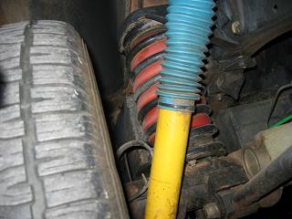

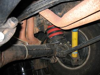

I have them fitted to both my discos and they certainly make a big difference to your ride as the air pressure is adjustable, however, if your springs are on the way out they are not an alternative.
