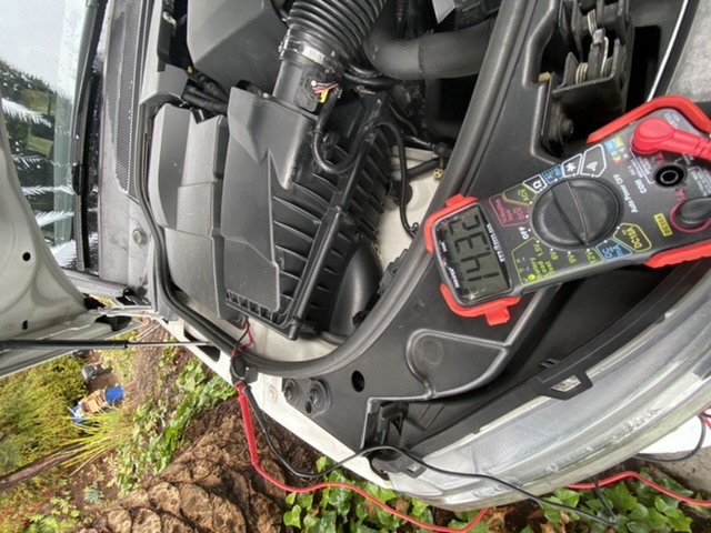

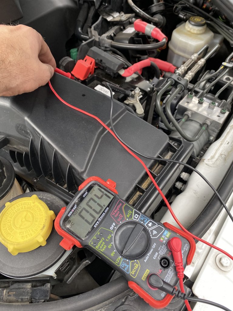

Ok here is the multimeter results. 6509E7DC-42BE-4BE0-8D3B-3F20BCA30606.jpeg 06A6970B-43BD-4F80-BEA6-2E971BE0E041.jpeg
Nothing to the aux battery.
