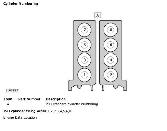

Hey guys, have a bit of dilemma here with this LR4, shocker there ;) 2011 LR4 and it has a little under 100k miles. the valve cover on the LH was leaking, changed it and since the injectors were out went ahead and replaced those and the plugs as well. put it back together drove it but then suddenly I got the lovely restricted perf. coming on and on my cheaper code reader it said the Cyl. 1.3.5.7 misfiring! I didn't even work on the RH. the only thing I did on the Right side side was replacing those PCV caps with overpriced dealer ones, so then I thought maybe I had forgotten to put a spring back on one of them or something. I pulled those off but no, the springs were in them. One other thing, The radiator was leaking, I must have hit that plastic ****** piece on top with a tool. I ordered a new one getting here today but, I wouldn't think that could cause a misfire or could it? would anyone have any idea or similar experiences? Thanks much in advance for your time everyone.

Finally installed the radiator tonight. Was bit of hassle to line up the condenser with Nissens radiator somehow. The car Fires up/starts fine after driving a little bit the Rest. Perf. and the reader shows Cyl 1,3,5,7. this is so odd I only worked on the LH Valve cover fuel injectors and plugs not the RH. Would appreciate any input and thanks

When you say LH valve cover. Left side when you are facing engine or left side as you are sitting in drivers seat?
1,403
lol. Ok just checking, I assumed someone willing to pull injectors knew what bank they were on but never hurts to ask. Yeah sounds strange. You pulled the fuel line that goes over the engine to remove your valve cover. Check around the PCVs again to make sure something didn't get jarred or unhooked. I would try a hard reset and see if it comes back.

lol I hear ya. I did have to remove the fuel line that goes across. I'll try the reset hopefully it will do the trick. Hoping to avoid changing of the cover on then RH I know there is a missing tab on one of the PCV fitting not the cab but the actual tooth or whatever its called! been that way though. Does a good OBD reader pin point issues? any recommendation on what tool to get for under $2k? Thanks

If one of the tabs are broken that could cause a vacuum leak, now I'm not sure if that would show misfire on 1-7 but it's worth looking into it. Same affect if your engine is running and you remove the oil fill cap.
