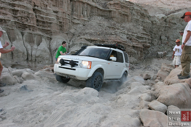

Yes, I have a NAS spec coiler. I think there are a total of 27 originally shipped in late 2004 to the States before formally being introduced to the market. I bought mine in 2005 specifically because it was significantly cheaper than a standard SE or HSE model with air suspension, and because at that time, the LR3's were having fairly major compressor problems that scared me.
Its good and bad. Very simply mechanically, and has proven quite reliable. I can fly down dirt tracks/roads at off road height at speeds far above the EAS limited 30mph. However, as Horum pointed out, I have substantially less articulation than the cross linked air bags. Fortunately, the superb traction control has effectively compensated for having a wheel or two (or three!) in the air, but if I ever have any money to invest in this truck again beyond stupid gas tanks, I want to customize the suspension to increase the articulation.
My coiler has been lifted to be +65mm taller than the stock Normal ride height, just lightly higher than your normal off road height (which is +50mm I think).

Here is a typical air suspension equipped SE:
Here is a shot when my truck was a brand new bone stock low rider (stock coils):
Here is a little bit more current photo:
