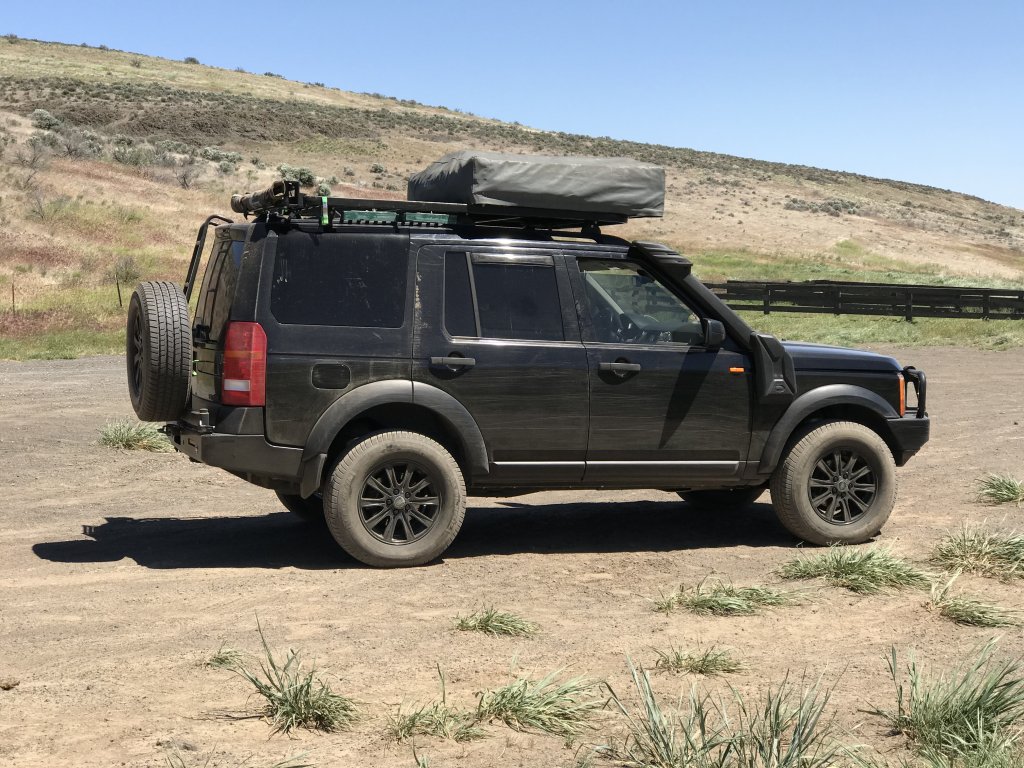

This might be a bit higher seeing as it was just coming off a fairly bumpy trail. These are Michelin MS2 275/65-18 which is actually a litttle larger tire than same spec numbers on BFG.

looks good! is the ride height in the normal height or is it raised?
as i said, might be higher, cannot recall but it sure looks like it is either in offroad factory selection or at least +20-25mm via my Llams controller. The tire are true 32" so they fill the fender and that much gap suggests probably still above highway ride height. hope that helps.
