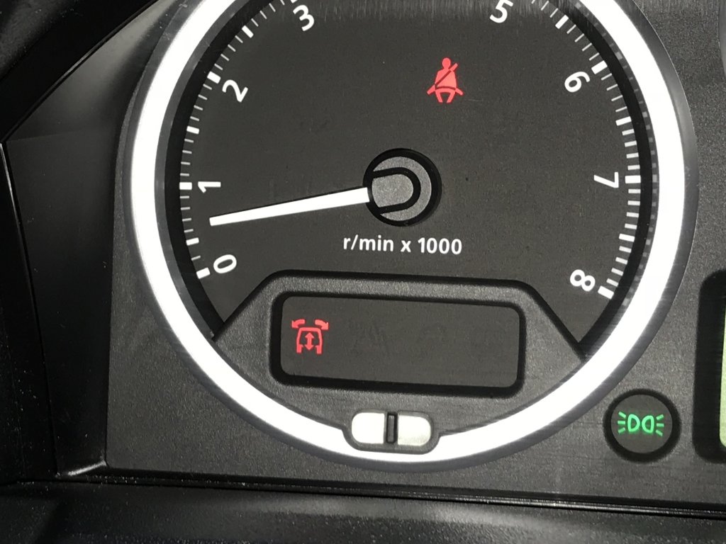

    I parked my 2007 LR3 for about three weeks in the garage and when I came back the suspension fault was lit in red. All special programs off it said. It was working just fine before I parked it. It has about 90k miles on it. I do not hear the compressor kicking on when I start and the suspension is completely down. Im on a budget at the moment so I'm a little afraid to take in the shop. Any idea what this is? IMG_4312.jpg

    Do you have tool to read/clear the codes? The compressor and special programs won’t turn back on until that code clears.

    based on what you've said so far, I'd first try swapping out the compressor relay - that's a common fault and it's pretty cheap, plus it would disable the compressor. if that doesn't work you'll probably need to read the codes and see what's really going on - it could be a couple things.
    From there I'd try to determine if it's a bad compressor...possibly from overworking it due to a leak (external from an air strut or internally from a valve block o-ring). There are a few good youtube vids on how to determine if you might have a leak but that would be secondary to your pump.
