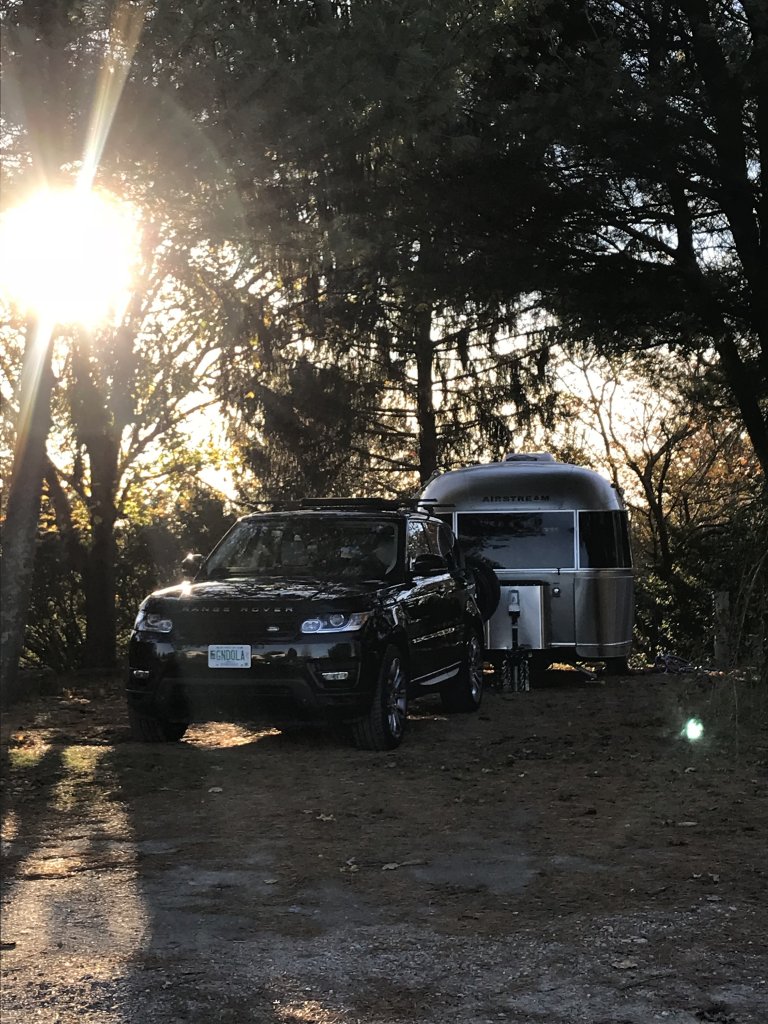

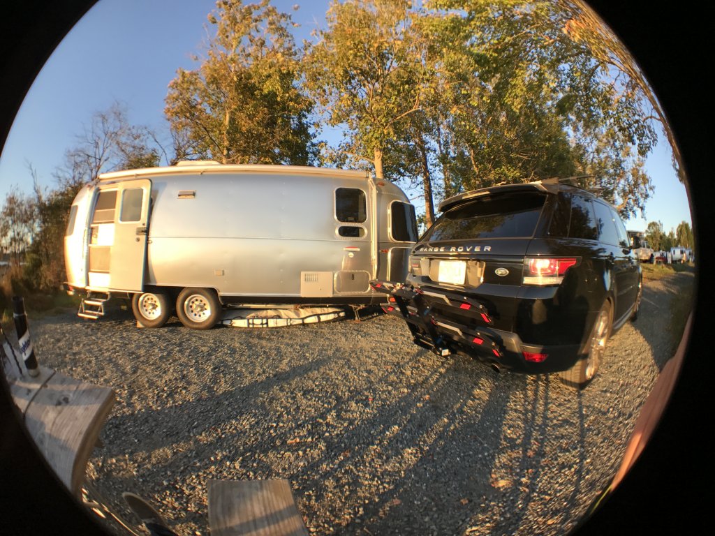

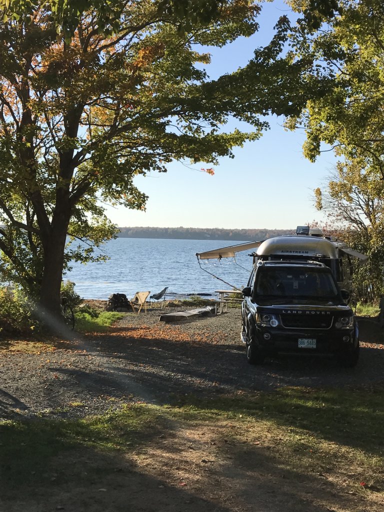

Sadly I don't have any pictures of my actual tow set-up.
Used a 1200lb sway kit mated to the curt class III with LR rear wiring, ford plug, and tekonsha brake controller. Towing a 25fb International Serenity.
Few pics I have with both rigs
