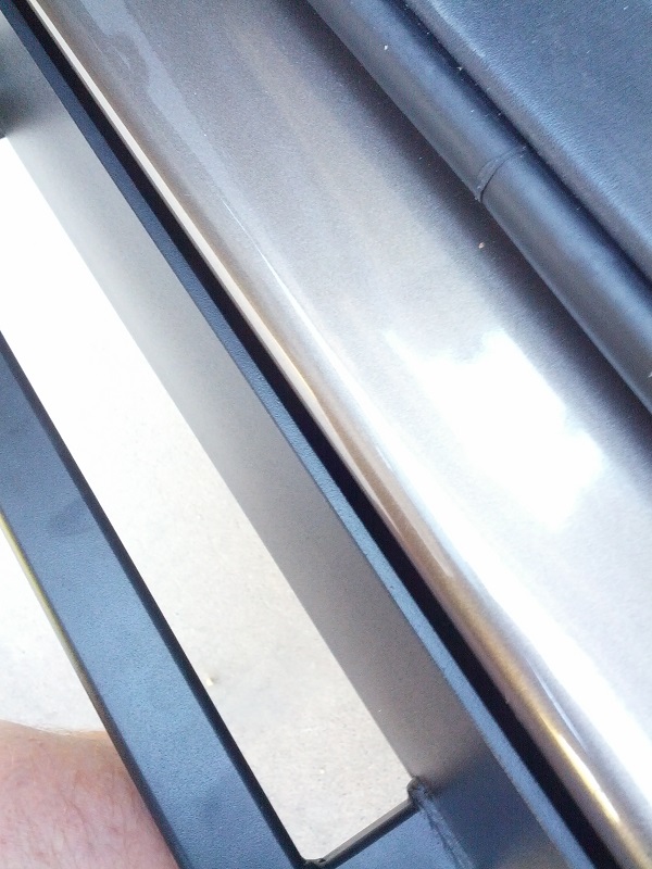

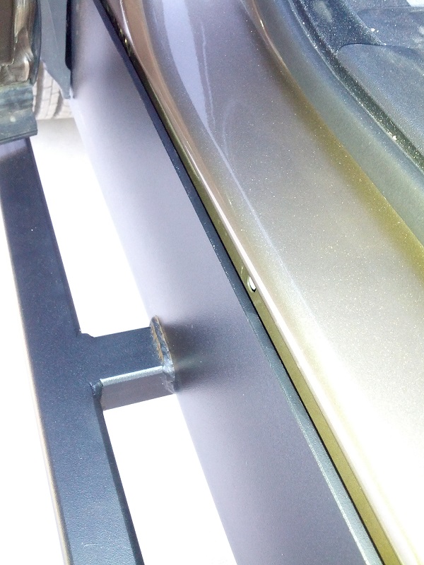

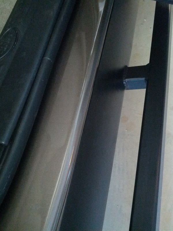

Thanks for your great post. Finally I had my T44 rock sliders and compressor bracket installed on my 2013 LR4.
I love the product. Nice, high quality and "Made in USA".
I asked you before regarding the noise and you replied that you did not noticed anything.

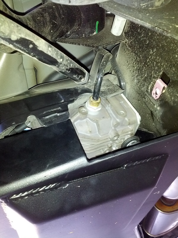

I am afraid that my installation is not right. I can hear and feel noise reverberating in the cabin. Very noticeable and annoying. I noticed that black plastic cover which is on the top of the compressor can be easily moved I think this transmits the vibration. I took some pictures ( squeezed my cell phone camera between the left rear wheel and compressor) . Do you have any pictures after your installation from that perspective??
Another " problem" is a gap (about 4 mm) between my left rock sliders and the car when you open the door and look at the slider from above. On the right side my rock slider looks almost flashed, no gap.
Could you take a look at yours let me know .

It looks like I am having a problem uploading more then one picture.
This is the compressor picture I mentioned about in my reply. Anyway, I will have to visit my installer on Monday.

TLB, I haven't experienced either of those issues. Although I am pretty sure my compressor upper cover is hanging loose up there as well (only the lower one was removed), I get no vibrations from the area at all. Even when the compressor is running, it appears as quiet as before, if not quieter... Also, both LH and RH slider sill panels stay flush against the body on my install, something definitely looks slightly off in yours.

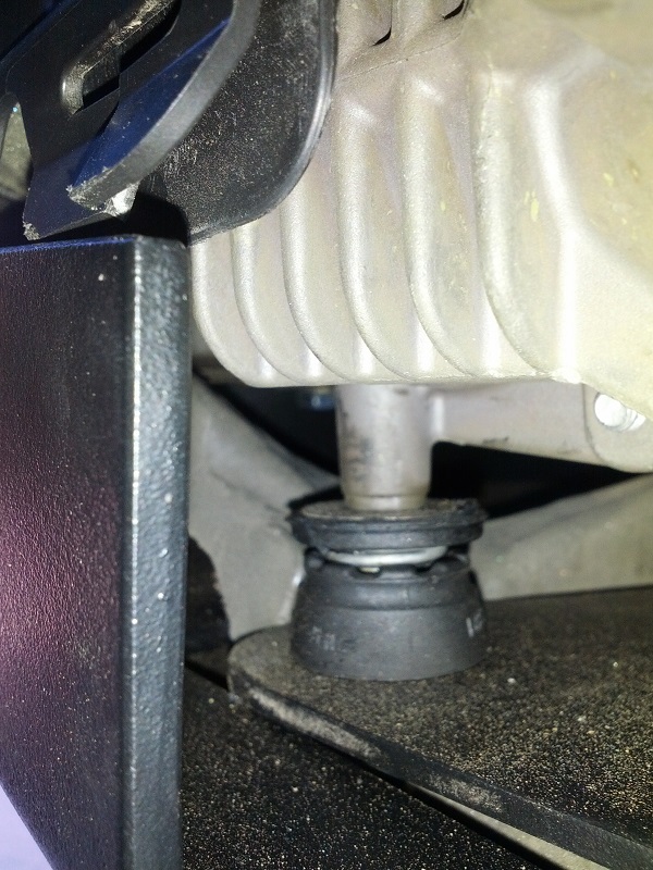

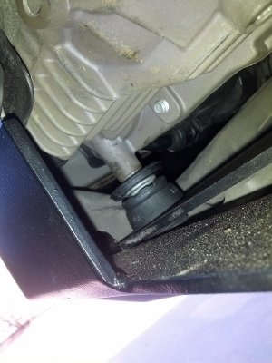

BTW, I think I figured out the reason of noisy compressor. It looks like the bracket is in contact with the slider and this transmits vibrations.
I just hope that the gap and compressor noise can be fixed with just repositioning of the sliders.

These are photos on which it looks like the bracket is in contact with the slider.

There is definitely clearance between my sliders and the compressor bracket, no contact. Given the sliders design, I am more inclined to think that the compressor bracket in yours wasn't installed properly. Either the top bolt wasn't tightened all the way (it's real hard to reach with the compressor in place) and the front end of the bracket hangs low as a result, or they need to loosen all bolts and push the bracket up a little - the holes for the 3 bolts on the T44 bracket do allow for some vertical play, as you can see from my photos.

Finally after some corrections my left rock slider and compressor bracket do not touch and the left slider is positioned closer to the car.
No vibrations after correction.
I think I can hear the compressor a little more than before sliders were installed but this is not a big deal.
The gap between left rock slider and the car is almost gone. The fit is not exactly the same like on the right side but close enough.
