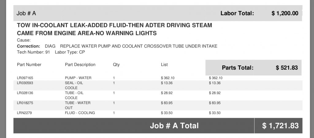

Yup, the intake hoses were also changed. See parts listed on the invoice.
I’m based in Jersey City - so it was far from home where this happened. I had extra coolant with me but since it was leaking so bad didn’t think it would have helped.
Same problemo for me, I ended up making the mistake of putting green coolant instead of orange LOL. Anyways I didn’t mess anything up 30k miles strong since my water pump change!
I just kept refilling her up and drove to my mechanic in Long Island city Queens NY from Jersey even when it was spraying like a blown up fire hydrant.
Changed water pump for $450 parts and labor. Then I had to go back next day because it was leaking again.
The water pump has two parts that should always be changed simultaneously for a good fit. So another $100 later and they replaced the second part and haven’t had a problem since. They even threw a stabilization link for the inconvenience.
Next time If I notice a leak I’ll be heading to the mechanic.
