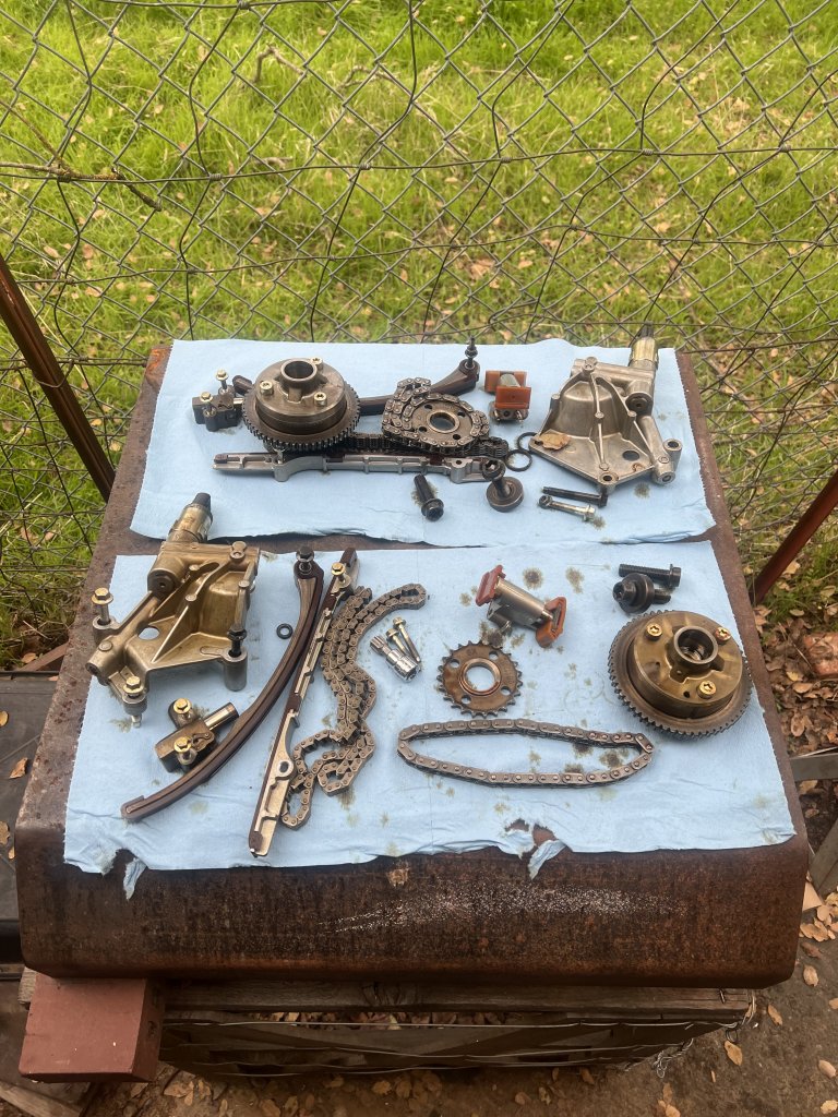

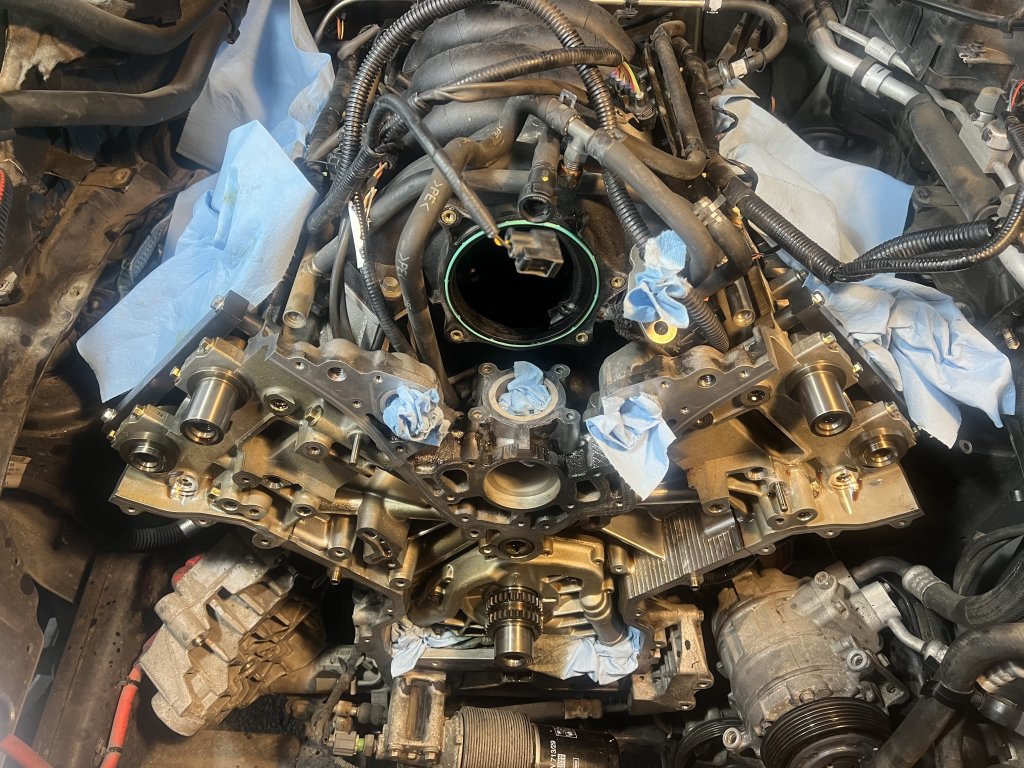

+1 on parts quote; labor feels right too. You have to take a lot of stuff off to get to the chains. I put in new belts, idler pulleys, water pump, thermostat, coolant hoses I could get to. My ‘09 sport is a different engine, Atlantic British has a youtube for a ‘12 RR Sport if you are curious.
