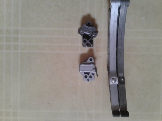

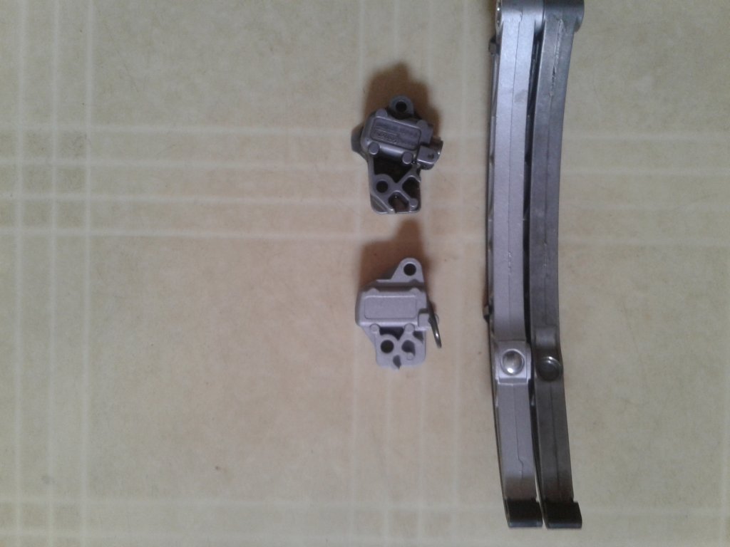

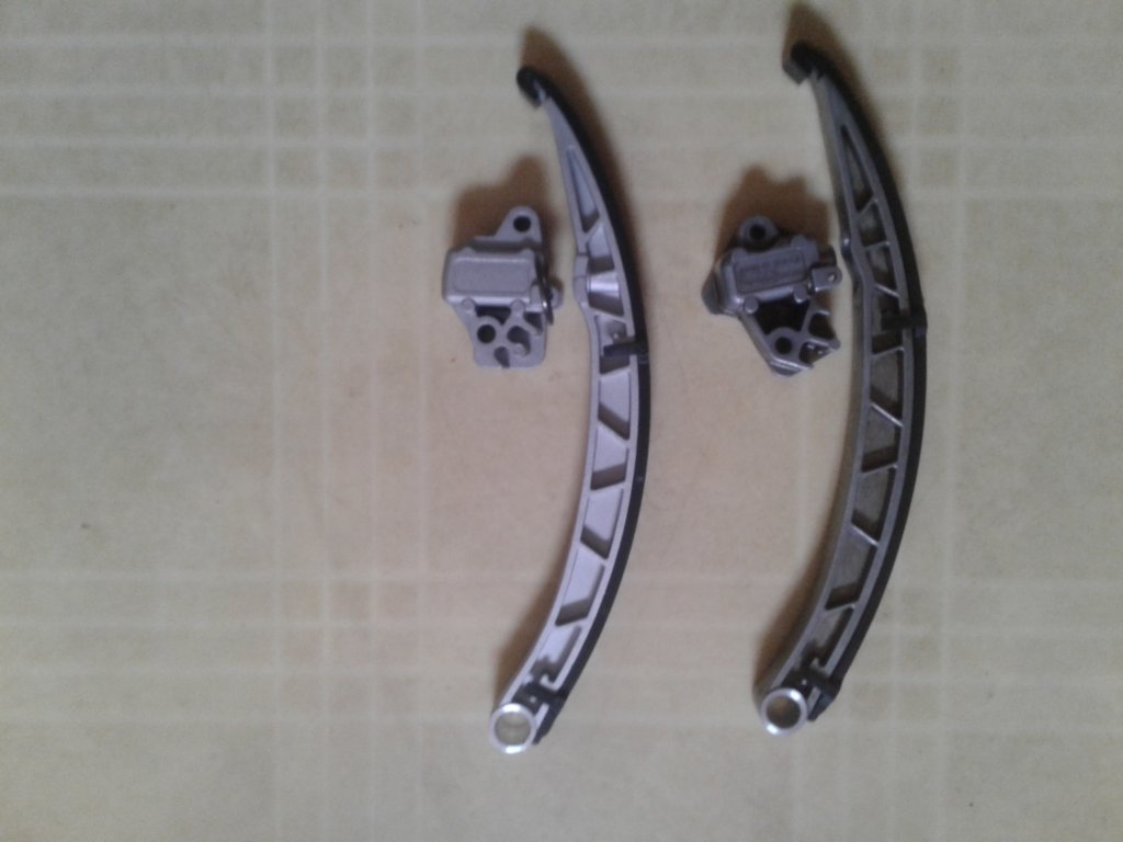

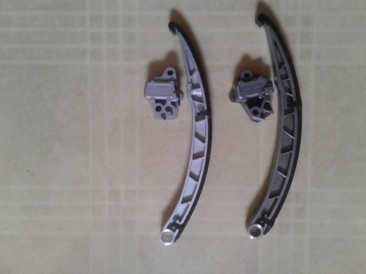

I purchased some non-genuine parts and have found they are way off from the ones removed. The tensioners are designed with a different angle that strikes the tensioner plates in a different spot. Has anyone used these types of replacement parts and will these work

Thru E-Byay, WOPARTS with a red star in the O.

I think the actual Land Rover updated timing chain tensioners are at a different angle than the original design, so these could be correct.

That's what I thought, how many folks replaced them without even realized they were different or figured them to be designed differently. If the jumping cat parts are different too, then so be it. Just would like to verify.

The angle of contact was changed by land rover due to the initial engineering design flaw with the tensioner arm. I bought a set of LR and they are stamped FOMOC Ford motor corp. As to the quality, you may get a good part. I have experienced that some of LR parts are of questionable quality and have used Aftermarket parts and they work and wore well.
