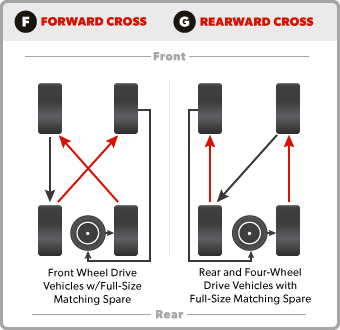

After doing some research, I have been doing five-tire rotation ever since I have gotten a new set of five, and this is the pattern I have been following (pattern G, the one on the right):
I wanted to include the spare in the mix for all of them to wear evenly.
Also, right after rotation, I avoid pushing it at least for a few miles for the tread to settle in and get used to or adjust to the change of direction and torque levels, etc.
