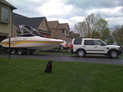

I tow a 23' boat, 6500lb (including trailer) no problem. I have actually towed this Rinker 232 BR behind a few vehicles. In order of preference/enjoyment: an 2002 Chevy avalanche z72, 2006 LR3 V8, 2005 toyota 4runner v8, 2008 Toyota 4runner V6, 2001 Toyota 4Runner v6, 2003 GMC Envoy, and in a pinch for short distances 2003 Nissan Xterra V6. None, even the xterra have had any trouble pulling out of the water.
