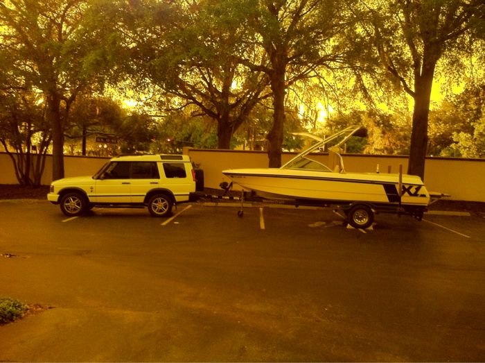

I tow a 6000 lb boat.
Agarabaghi
Nov 13, 2007
127
Boat - 3200lbs dry, trailer 1200lbs, there maybe 500+ lbs of stereo and gear on the boat... and thats assuming we remove the 600lbs of lead hidden under the seats...
