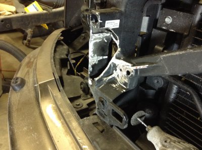

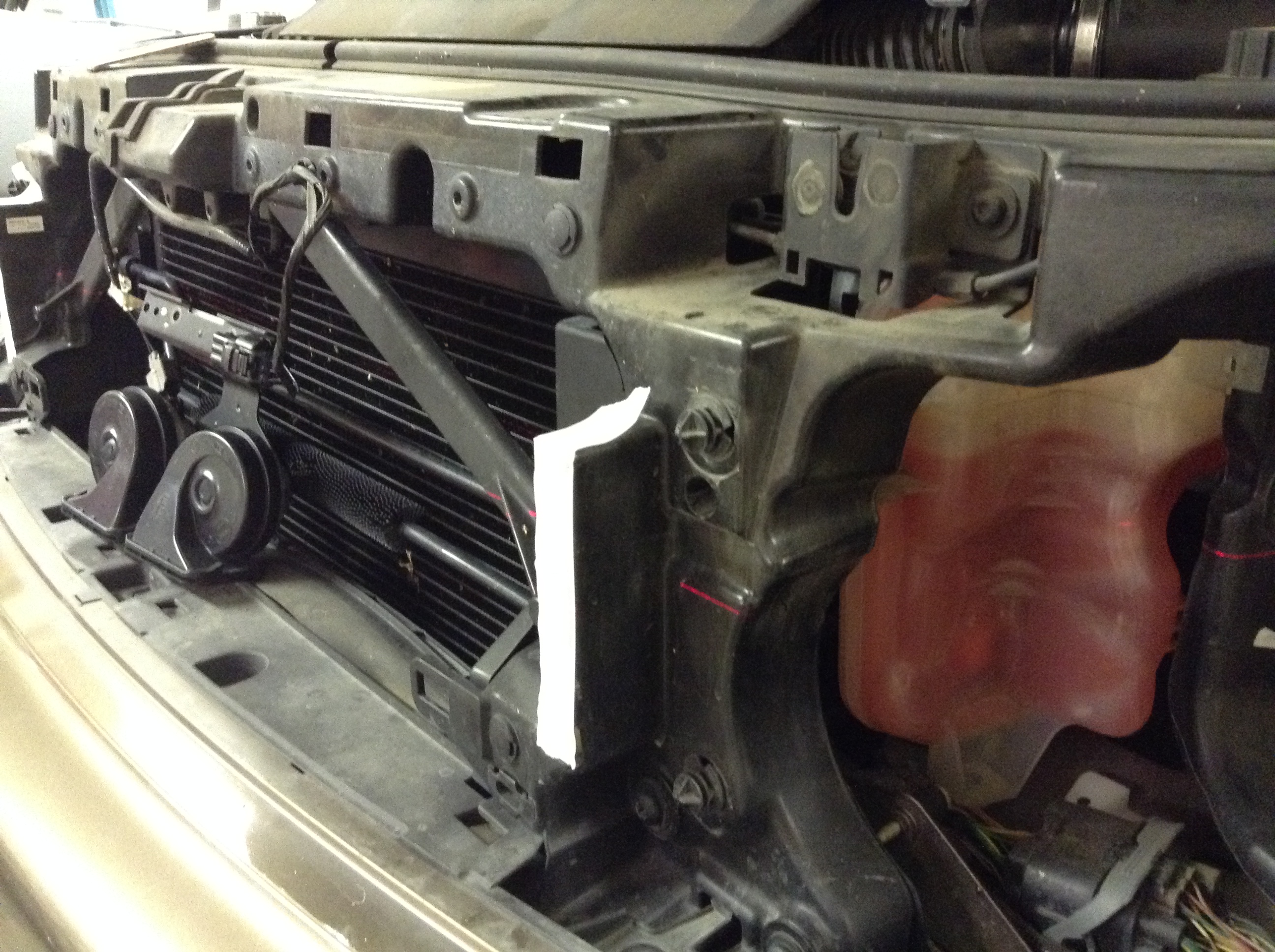

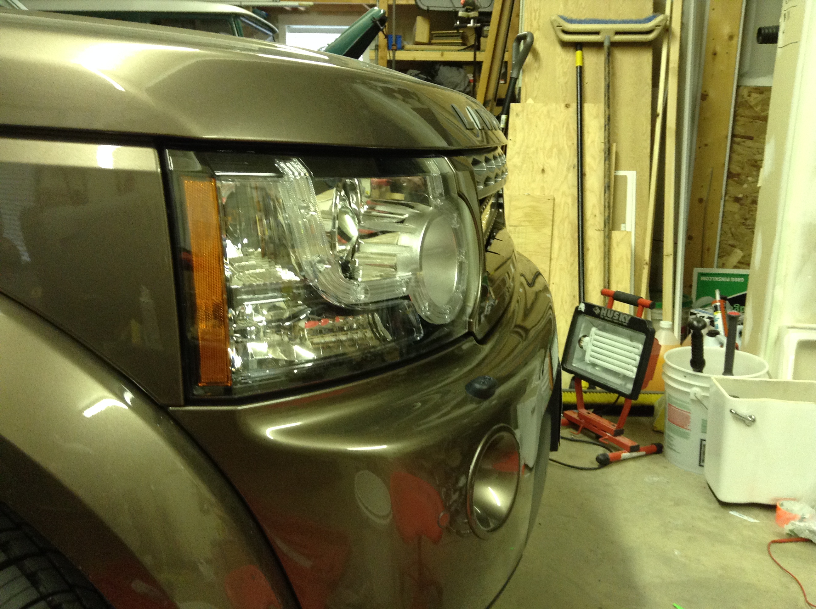

After removing the headlamps and front grill, there are two 6" tall by 1" wide support brackets (see photo) dedicated to keeping the front grill from pushing back into the radiator core. Turns out the outside walls of the support brackets are exactly the same distance apart as the mounting screws + the brackets I made.

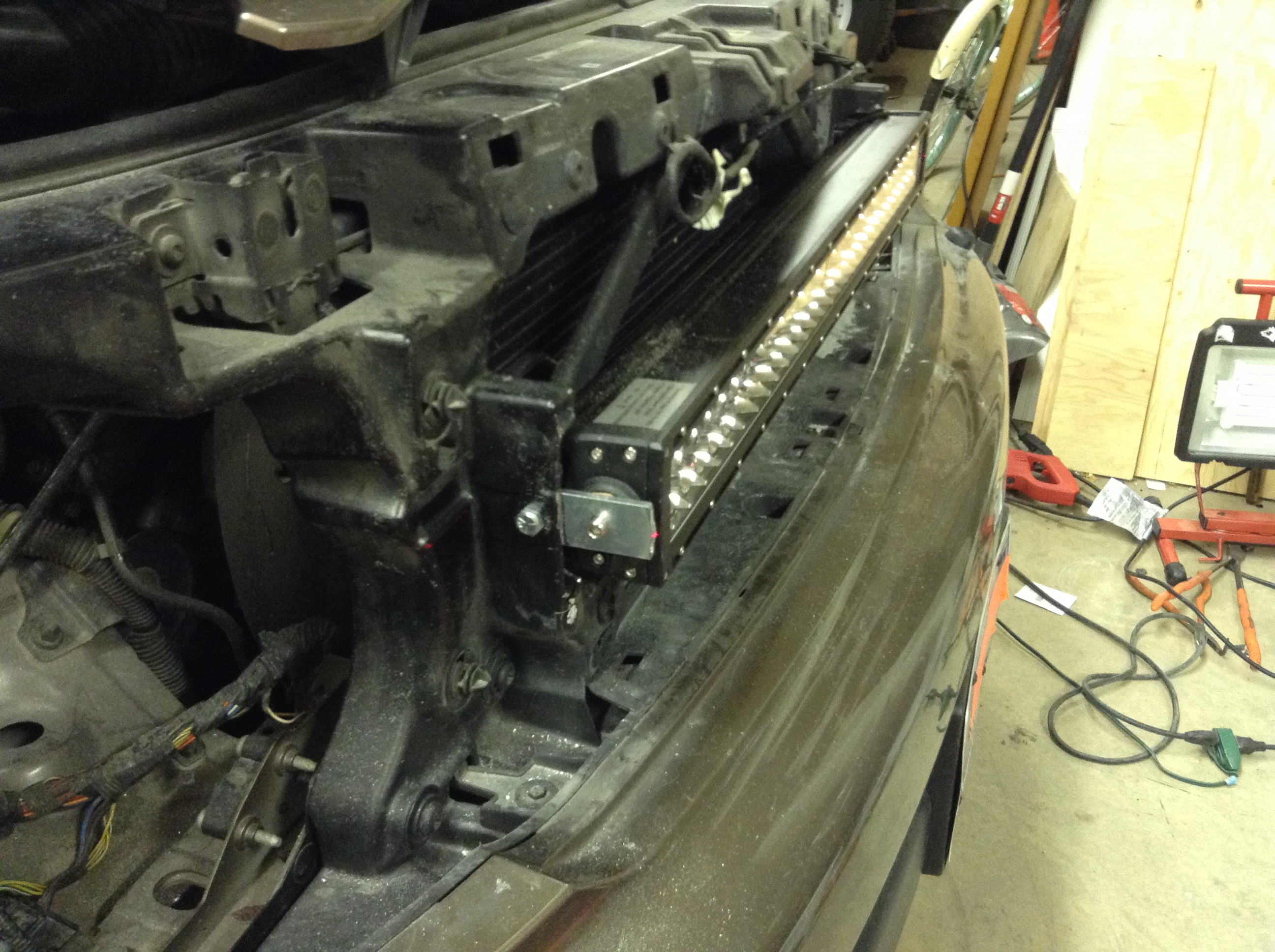

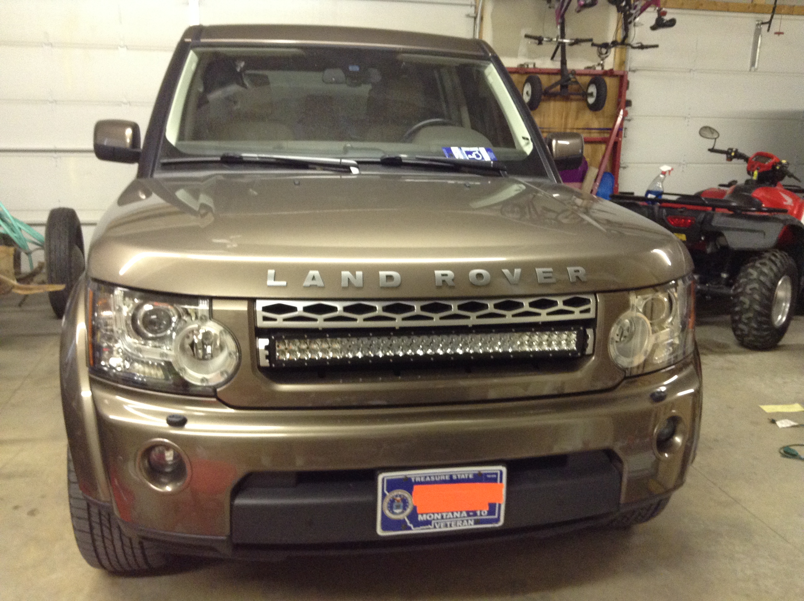

So I cut into those support brackets (after verifying no electrical connectors or airbag sensors were present) and installed my light bar. Then I removed the entire lower row of the front grill. Using my laser level, I kept everything true and straight and when installed, the Light Bar is recessed about 1/2" inside the front grill.
As a safety measure, i installed a master override switch into the headlamp switch assembly. This way i do not accidentally deploy the sun in traffic.
Yesterday we drove the 170 miles through the Rocky Mountains over to Missoula, MT and I was blown away with the outcome. I have driven this road many times and never felt safe for fear of hitting deer (I have done this with my first LR4 and it wasn't pretty…for the deer!). The lights are so bright other drivers let me pass and then sped up to keep up with me as I blazed the way.
