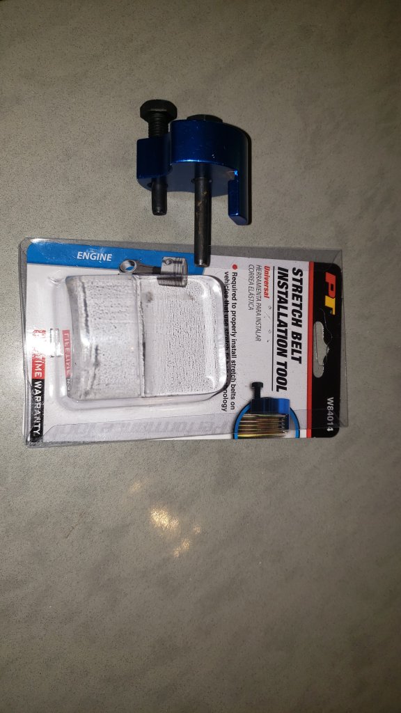

I have a new short drive belt, the stretch fit one. I offered it up and it looks woefully short. Before I cut the old one off (looks okay. No cracking), and commit myself, has anyone had success with the various stretch belt installers on Amazon? I know about the small mole grip method. The old belt looks okay, so am in two minds as to whether worth bothering with. Mileage is 180k km, and replacement indicated at 240k km

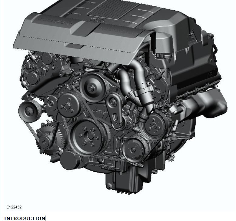

Could not find a good routing diagram in the manual. But this might help.
Thanks for the diagram. Longer belt replacement no problem. Its the short belt off the crankshaft I am referring to

Hey, thanks.
Yes I did look at that tool.
Ordered a different one. Will see how it goes :)

$25 tool off Amazon worked a charm with the stretch belt. It seated it almost correctly, just had to apply some leverage with a large screwdriver against the outer belt edge while continuing to rotate the pulley to fully seat it. Old belt looked fine.
