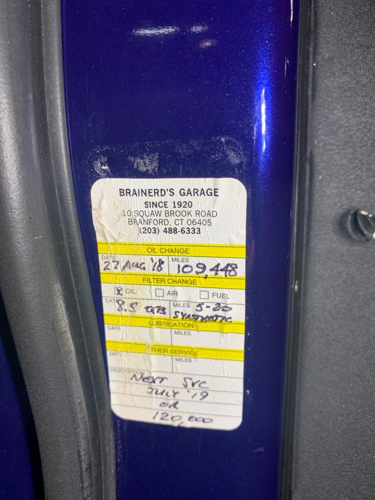

Noticed this on the door today.... it’s better than nothing...
