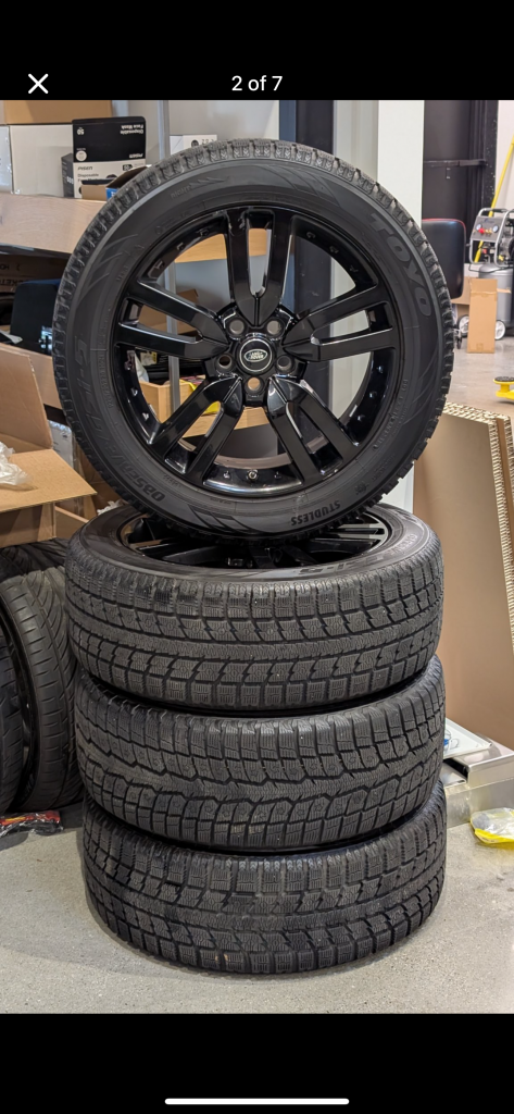

I am looking for some new wheels/tires for my 2013 lr4. The attached are listed for $1300CAD on market place.
Description: Land Rover Range Rover Snow Tires Toyo Observe GSI-5 265/50/20 106h
Will these fit? Is it an ok deal? Any advice?

Those will fit, I feel like that’s an ok deal if the tires are in good condition and wheels are perfect. If there’s even a scratch on those wheels then I would say 1100 max is fair

I would pass, the third tire is different than the rest. Tires have no value. I much prefer 19" wheels in a stock 255/55-19 for a winter tire. For our US friends $1300 Cdn = $915 US.
