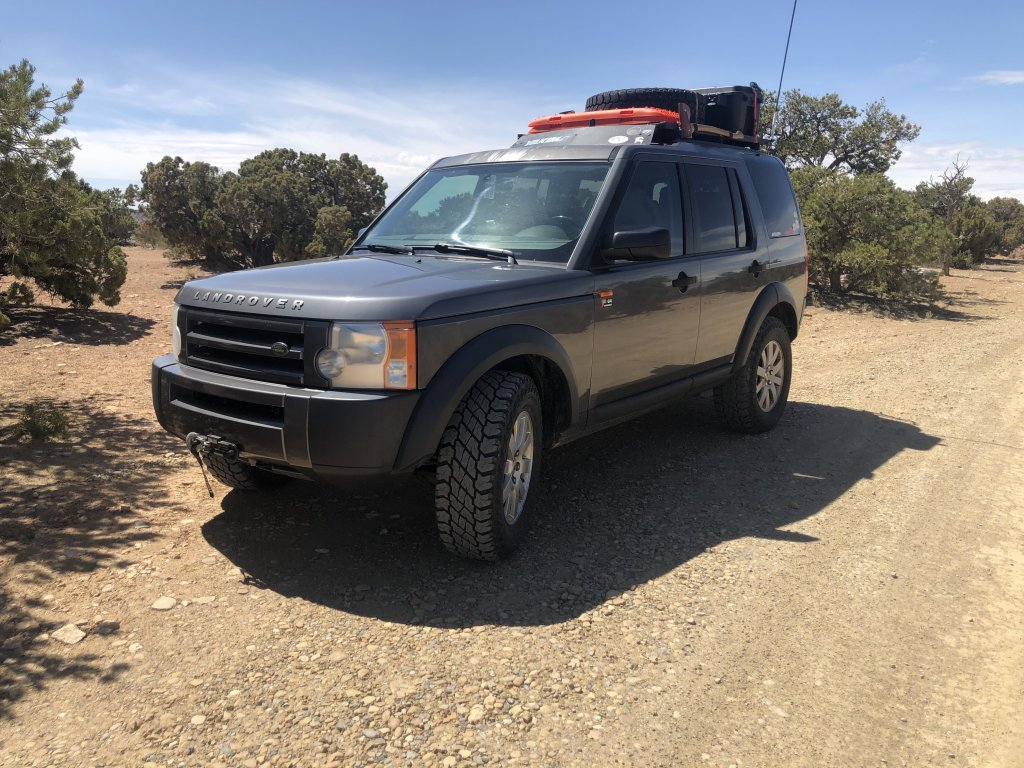

Good point on the width...maybe I should consider that for my next tire size. How does that look? If you have any pics, I'd love to see.
I have ride height programmed to +30mm with the GAPtool.

Those look good! Not too skinny...
If you think the negative effects on road are minimal you may just be forgetting! I swap back n forth between stock size and 275/65s...and it's always profound to me.
