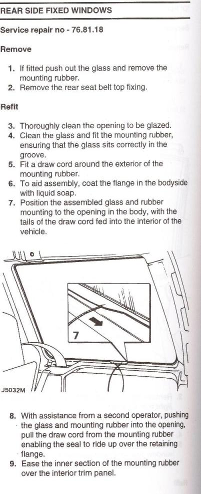

Probaly like a lot of you guys with Disco I's my rear three window seals/gaskets are rotting away to nothing. I have replace ments for the buggers but I gave it a loo ad thought where the heck woud I start. Any one have and advice or expierence on replacing them? I would like to do myself if possible.

I have a new pair of side window seals ready to install, too. I did the same thing...thought "how in the heck?".
I'll probably give it a shot this week. I am trying to attach a copy of my instructions...
Note the first step..."If fitted, 'push' out the glass and remove the mounting rubber."

please let me know how it goes for you. If possible could you take some photographs of the process espically the difficult steps?
