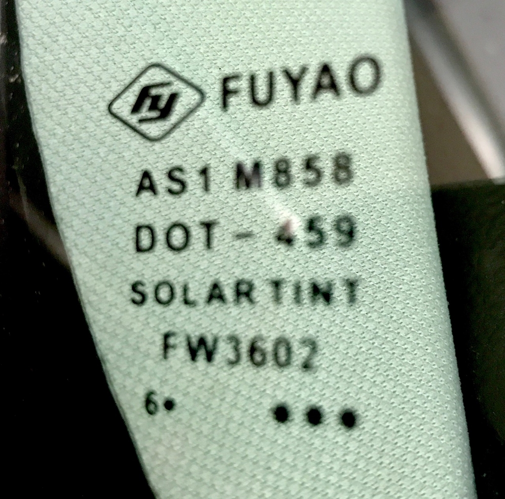

Can you describe the green tint? I don't notice it. Is this something I can see or is it documented? I have the FUYAO glass shown below. My rain sensor is very poor at detecting rain. I'm thinking this is what you were talking about...
Yes, that is exactly the one they installed. You probably won't be able to notice the green tint unless you are comparing them side by side with pilkington.
I would have them replace it if you can.
