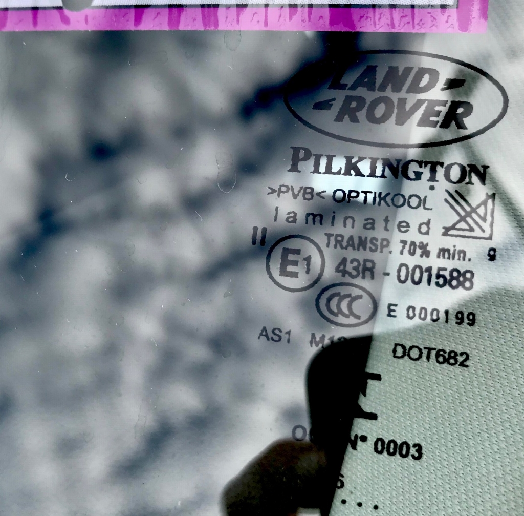

My new windshield! Hope it's the right one. It has the little wires in it.
