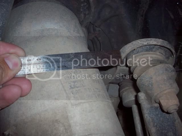

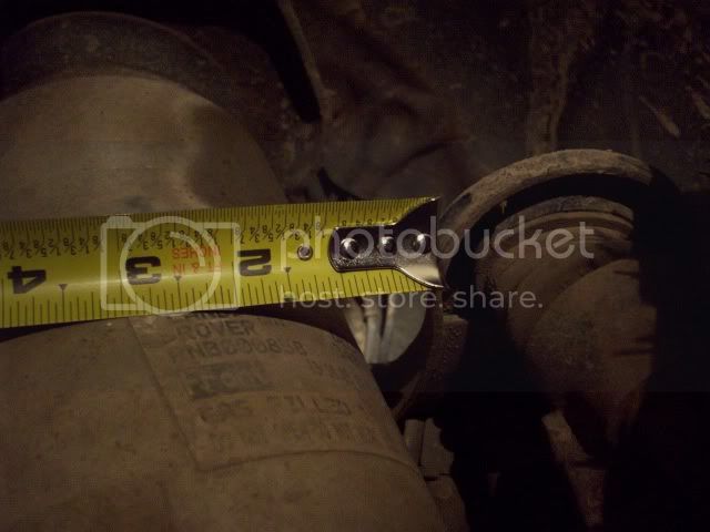

Duuuuuuuuuuude! Something looks wrong. Almost like the upper shock mount is tilted inward towards the a-arm. I'm headed down to the garage tonight to do some snazzy laser measuring on some of the suspension components. I'll definitely look around this zone and post up if anything looks odd. I'll be sure to cycle the suspension and take some readings. Sorry man. That blows.
blackforestham
Feb 4, 2010
338
Ryan - there's more going on here than a simple rub issue. There's plenty of room between the arm and canister. These are both fixed points and the tire only rotates AROUND the knuckle and will not be allowed to move closer to the canister, unless something else is going on. I would have a close look at your shock mounts - especially the upper one. I measure a minimum of 1" clearance here -
222,737
