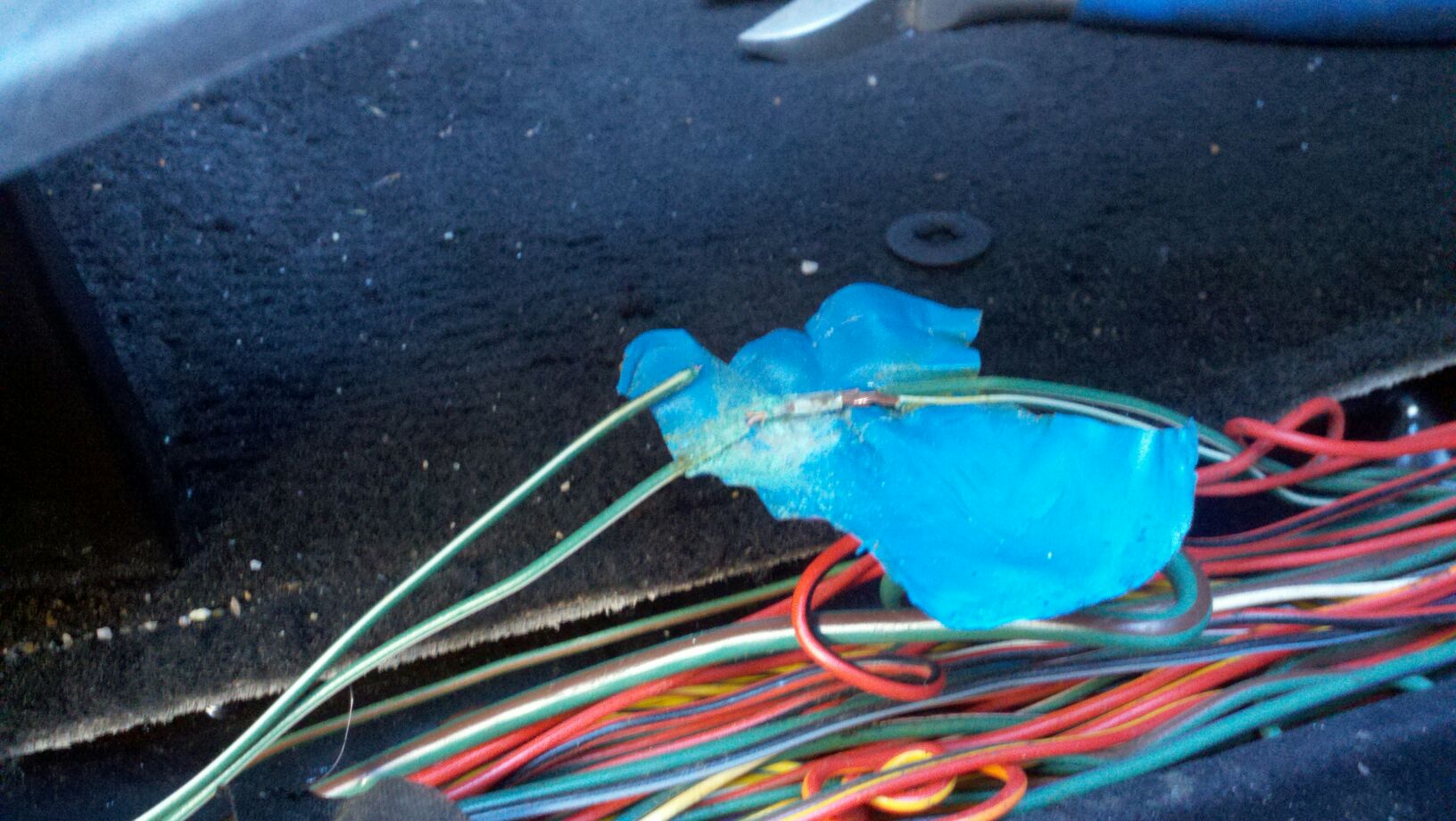

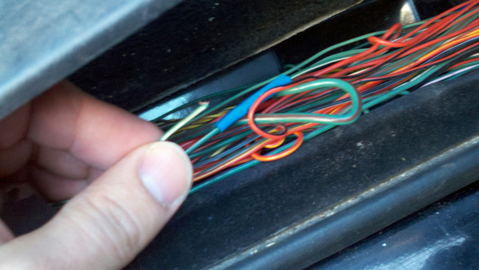

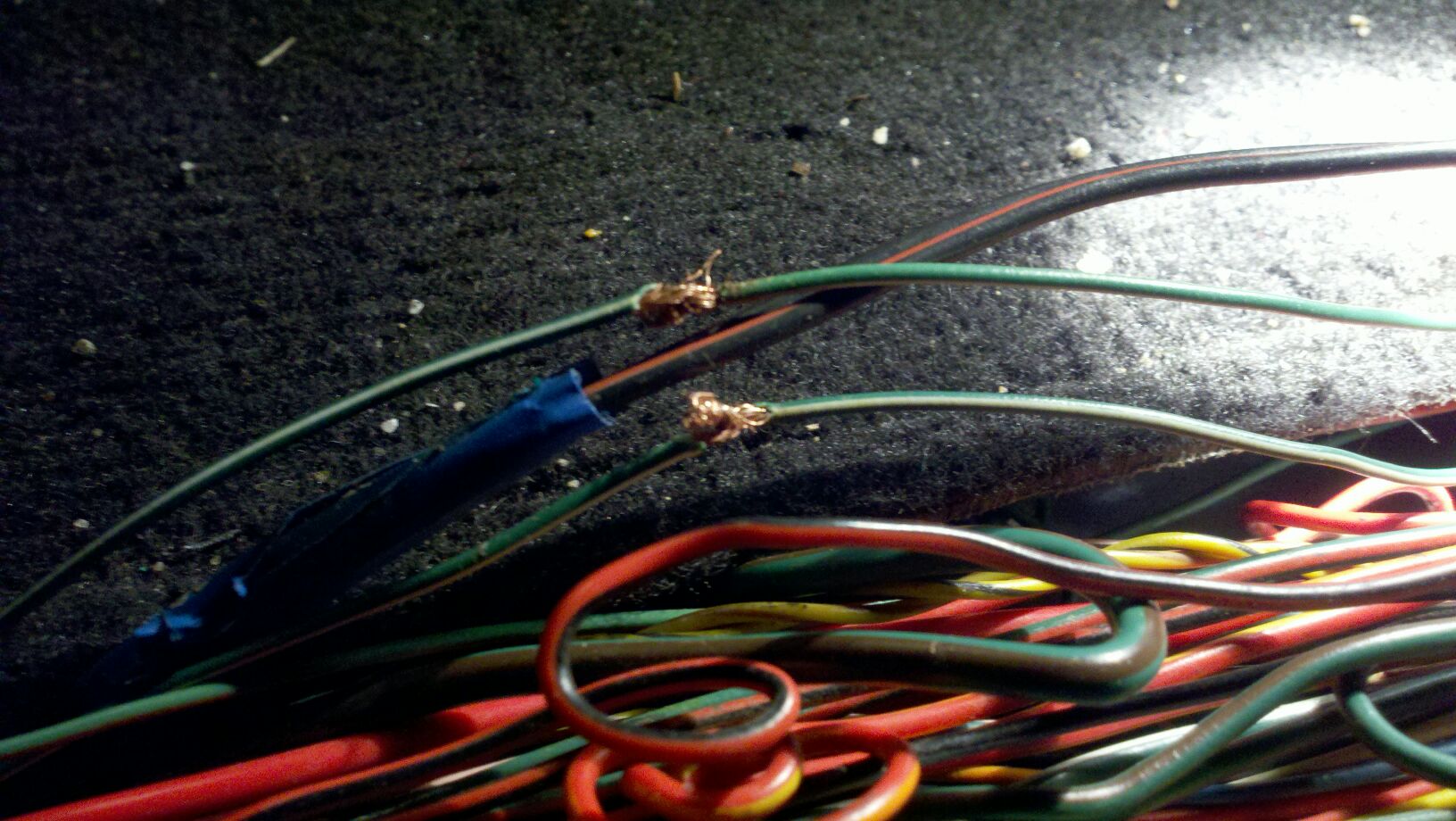

    05 wet floor and wire corrosion due to the issue.
    OK, guys, Spoke with the dealer, got some prints, but no help. Its ended up the LR knows about this issue for years. I got a tech bulletin from 06 saying that its 3 common problems due to the wet floor complain.
    1."WATER INGRESS TROUGH A-PILLAR EXTERIOR TRIM ATTACHMENT HOLES" Its a right side upper molding next to the windshield. Bottom pin is must be cut flash and patch placed over the hole. Under the foam gasket. All rubber gaskets on each pillar is to small to hold the water, They all must go. New ones are with larger rubber rings around.
    10 min for both sides
    2. "WATER LEAK IN THE FOOTWELL FROM ROOF OPENING PANEL DRAIN TUBE.
    Dir. quick check . Open roof all the way, poor some water on the side of the roof opening, its suppose to be 4 drains. right behind the front tires and in front of the rear tires, if you see water on the ground, you fine... :))
    3. Air duct gasket and foam insulation could be loose.
    OK, now, about the wires on the right side next to the door:
    1 splitter, 2 green/white wires that connect in splicer. small wires, probably the smallest in the bundle.
    Now, pay attention enthusiasts: DO NOT CONNECT ALL WIRES TOGETHER...!!!
    remote will not work, you must separate LINE IN and LINE OUT. will have to play with it...!!! Connect and try if remote is working, if not, then change the pattern, Simple...
