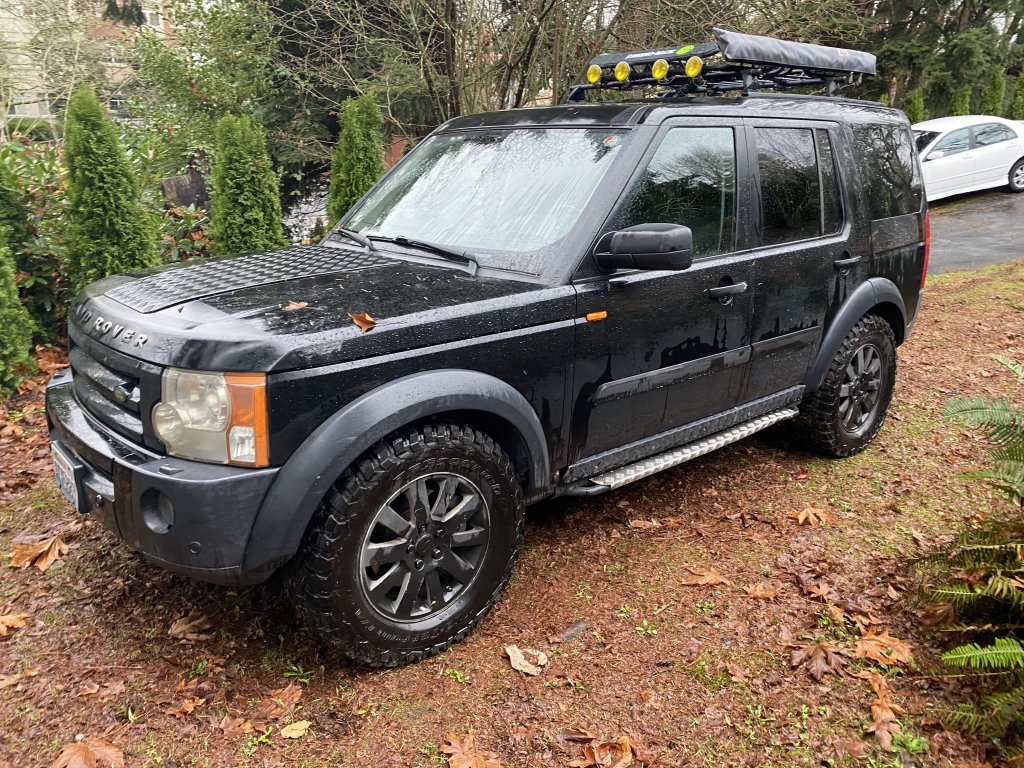

I crushed 3 fingers and required surgery and pins because I did not depressurize the system and the strut blew. Be careful. I was stupid and have suffered enough. Please be kind. It’s a very doable job and improves the ride significantly. I managed to insert a new strut 2 days after surgery and complete the rest a month later as I was healing. Did not have a IID. Taking the airline off the front valve block or the air line nut on the top of the strut depressurize s the system but DO NOT REMOVE THE BIG NUT FROM THE TOP OF THE STRUT WITHOUT DEPRESSURIZING THE SYSTEM. I made new air struts using generic air bags and Bilstein Sports shocks (yellow) all around. These are available from bilstein as a strut for the fronts only but are expensive. The ride is much firmer. Some modification of the top cap of the shock will be needed to fit into the air spring. I should detail this in a separate write up sometime. My 3 still settles onto bump stops after sitting a few days, even after rebuilding the valve blocks. I’m not worrying about it until it spring as it’s fine when driven daily and the pump is not clicking on very often.

My set up got me the thru Naches Trail in Washington from starting point 1 without any suspension failures. This is a not for the faint of heart trail. Sliders, KM3s (or similar) are a must.

At 100k miles, new bushings are needed. I get a lot of clunking up front. My 3 has 180k miles. I purchased all 8 new control arms from rock auto, got the cheapest they had available, all seem well built. Next summers project.
