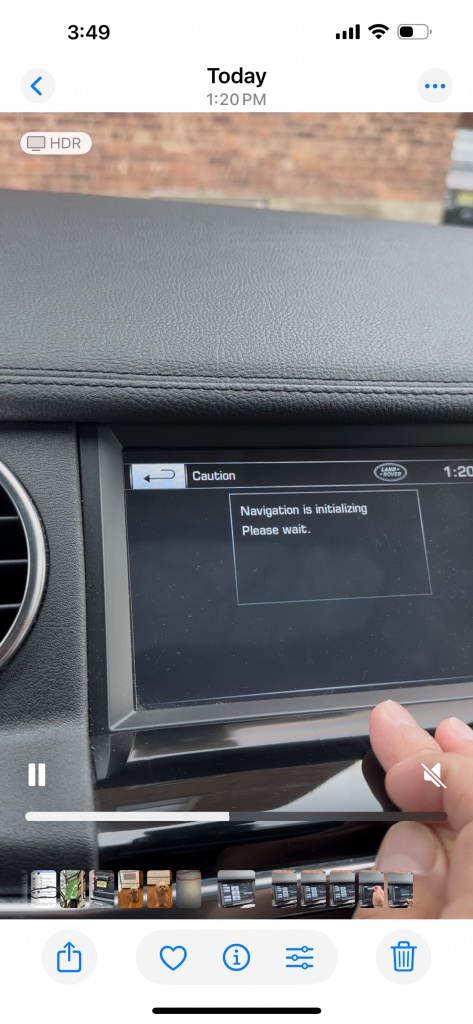

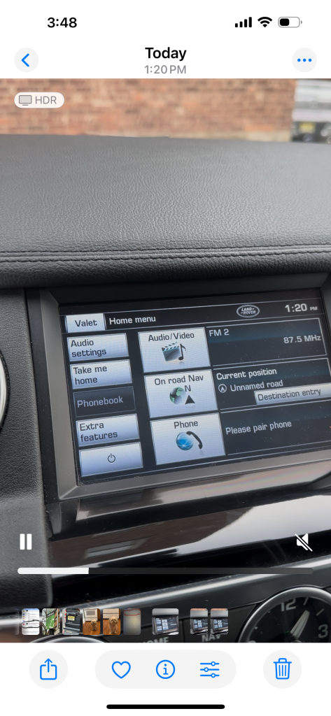

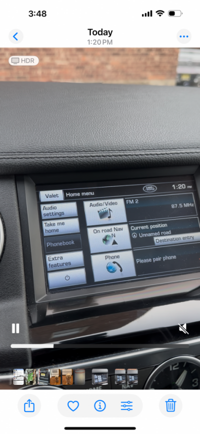

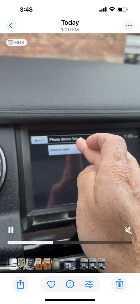

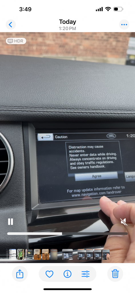

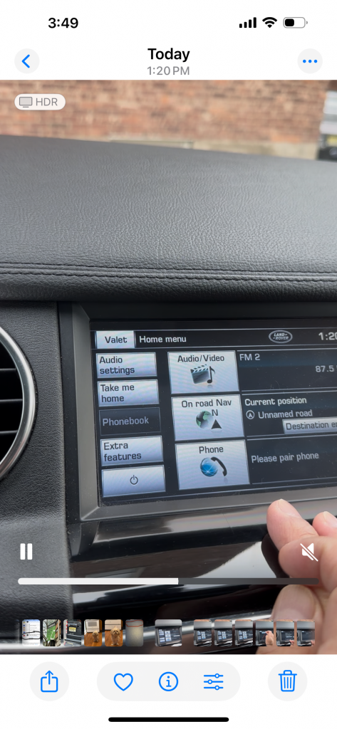

Yes, it is the screen rebooting every 10 seconds, the Landrover logo doesn’t reappear and it is like resetting the screen because when in reverse even the camera goes on and off in seconds, radio when rebooting goes to 87.5 and the in a second goes back to the radio station I put it. When radio is off you can hear the noise that the screen is rebooting.
If I try to start the navigation it doesn’t go to navigation because the screen goes back to home. If I try to go to any other setting screen it goes back to home. If I try to pair a phone it goes back to home when rebooting.
