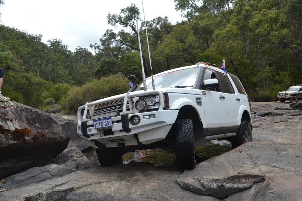

The 18" Compomotive rims and Cooper LTZ 285/60-18's work well on rocks and sand.....mud ok, but more aggressive would be better.
Tyres down to 18 psi took me through here without any marks....they mold over, stretch and twist nicely.
Very happy with this setup.

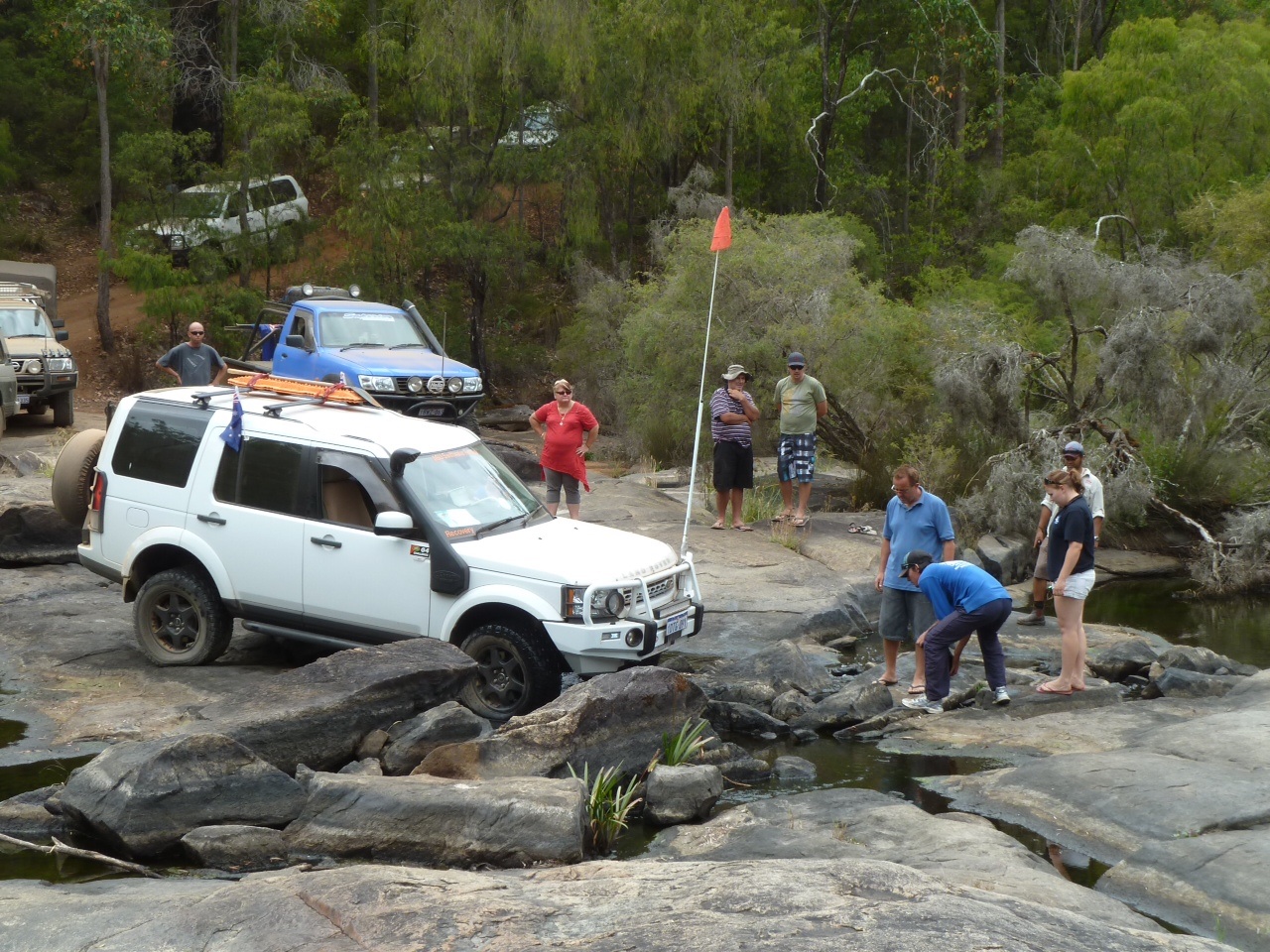

Brett...

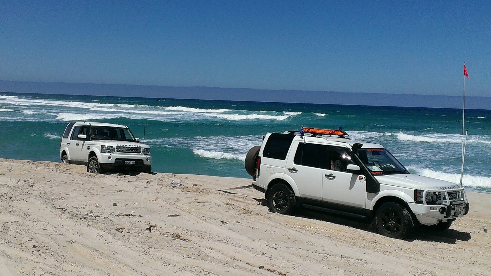

Did not add the sand pic.

I thought the intake for the snorkels were supposed to face backwards, so you don't get any rain or whatever in there...

In most cases they need to face forwards. On comp trucks, when there is a lot of mud and deep water, they will have them face backwards. Whenever I got through deep (real deep) water, I turn the intake backwards.
Heavy rain is not issue as the safari snorkel has a drain the allows water to run down the intake and out the bottom at the connection of the intake and the main pipe.
For heavy dust I use a snorkel cover.....a foam filter, but does not restrict intake greatly.
It's not advisable to run engine at speed (moving forward) with the intake facing backwards due to negative air pressure....can be very damaging on modern engines.
