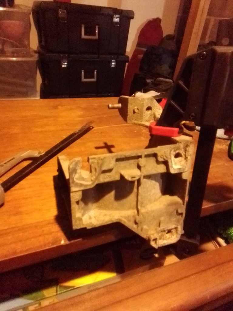

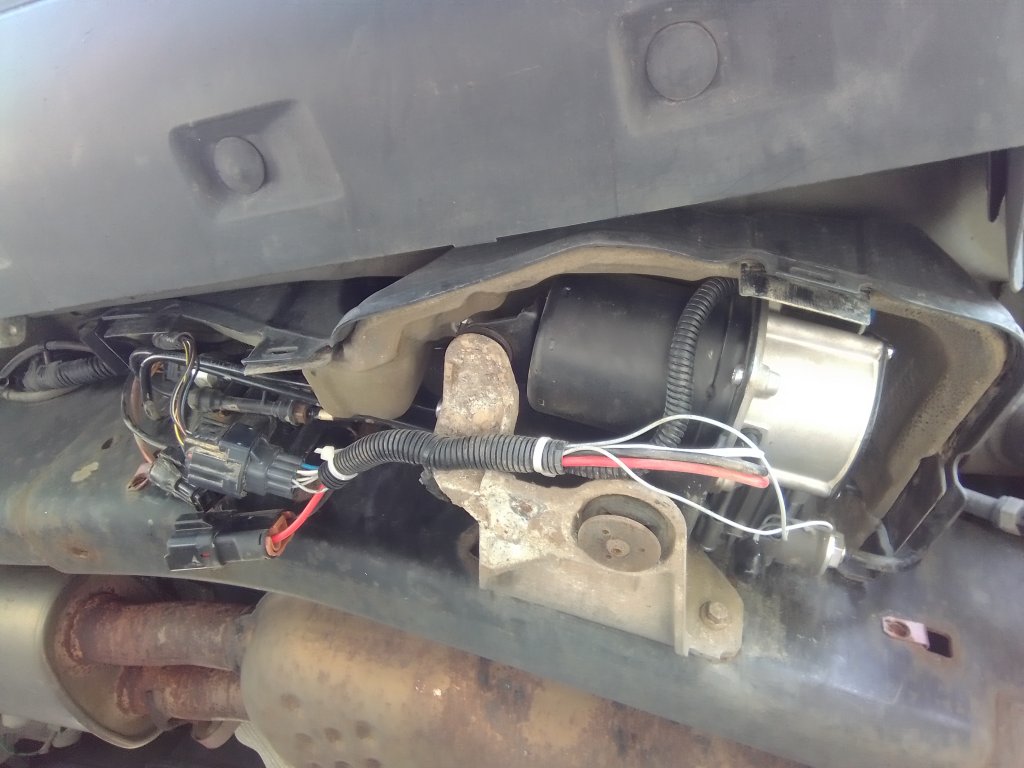

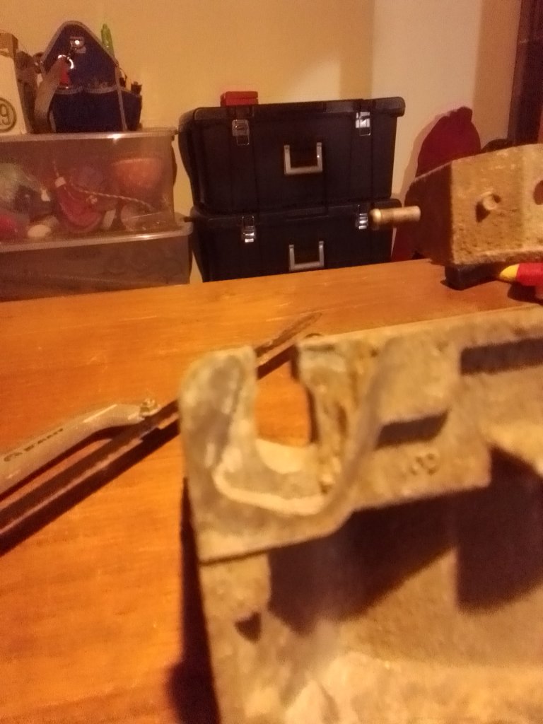

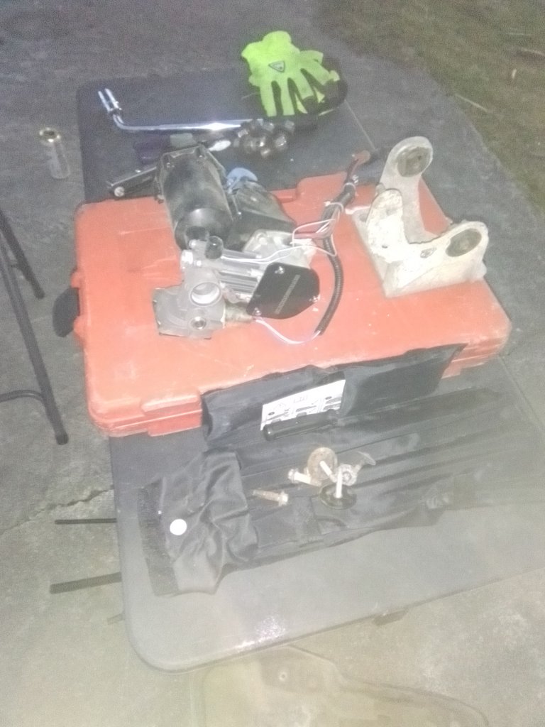

In full disclosure, I just replaced my cheap Chinese suspension air compressor last night and this morning with a replacement the Chinese company covered under warranty. The original one gave out at the start of the week and I was showing "Only Normal Height Available". Just finished up the install. Seems to be working (at least for now). They sent me the new one and didn't charge me a dime. One of the first real mechanical jobs I've done on the LR4 (or ever). I watched all the videos and went real slowly, carefully. It wasn't too big of a deal and now that I have done it and know what is involved, I can see it being a pretty routine swap out in the future. I understand I should go OEM or with the genuine Hitachi and I will once this one dies. For me, it was an opportunity to do something myself on my own rig, develop some mechanical competence, and a sense of accomplishment and ownership that can only come with "sweat equity". There is an impossible hidden bolt high up on the mounting bracket that attaches to the frame and I took the advice of one video mechanic and slotted the mounting hole to allow me to slide it over the started bolt. That was great hack and I never would have been able to get that bolt back in without that tip.

I can't remember what I've used to get to that top bolt, but I got it fairly easily.
It was either a ratcheting box end, a wobble extension, or a flexible extension.
Then again, I have AMK, and the mounting bracket is a little different than Hitachi.

I could do an AMK in probably less than an hour and a half. It's one of those jobs that takes you far less time to do a second time than it does the first.
Only issue would be having something you feel safe lifting the vehicle (jackstand, jack, etc.) and crawling a little underneath while the suspension is deflated with the compressor removed.
Suppose if you are somewhere rocky, you could stack up a few piles of rocks and put the driver's side wheels on them before you start.
