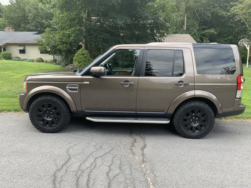

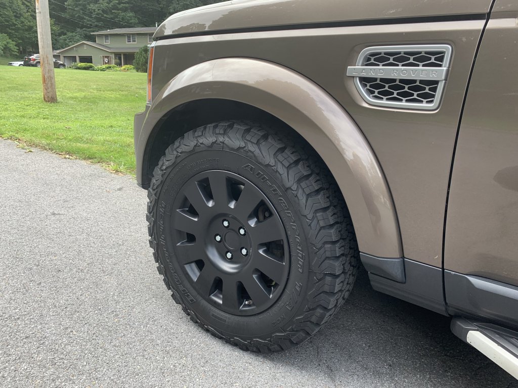

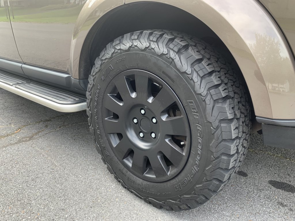

i run MudTech 18x8.5 on US version LR4 V8 with BFG KO2 265/65R18
no rubbing no modifications. no lift, however, i do use XLifter EAS controller without rods. but it is not required to fit the wheel/tire combo i'm using.
