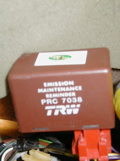

What exactly does that emissions reminder do ? I've got p1313/14 codes and I've changed my o2's to no avail. I was thinking of changing the cats next but I seen that and was wondering it's purpose.

Emissions reminder just turns on the service engine soon light (not check engine) on the D1 every 86k miles. pretty much a waste of space and can be removed and thrown out...
