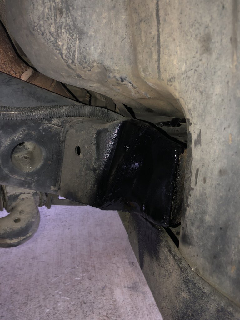

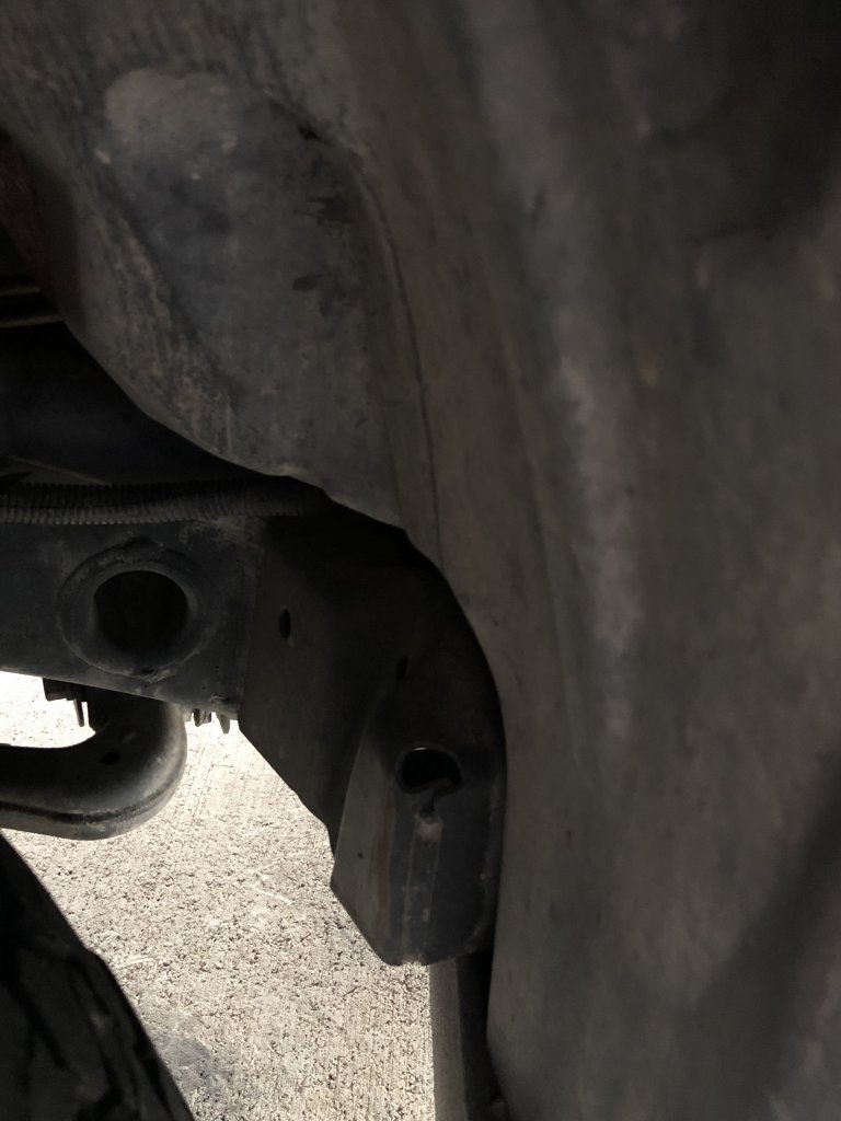

    • Frame horns were trimmed accommodate the 275/65R18 tires.
      The combination of 2 ½” lift, 18” wheels and new 275/75R18 tires, the ground clearance of the LR4 now reaches 14 inches.

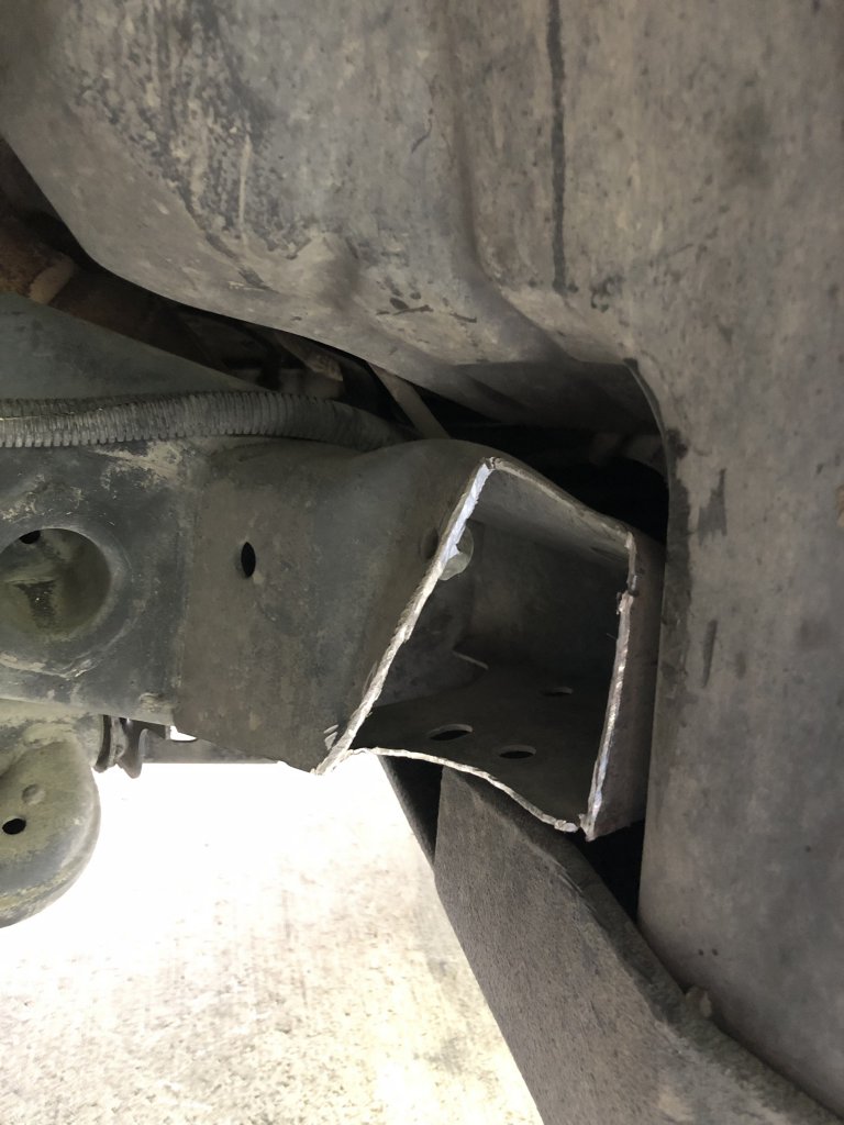

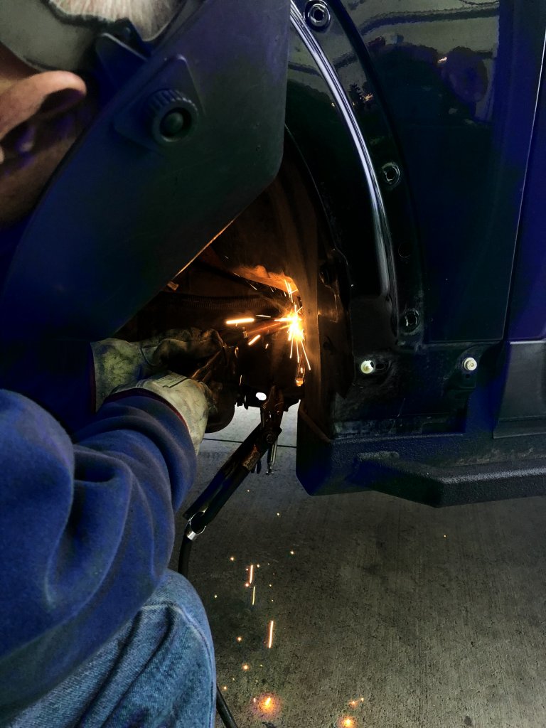

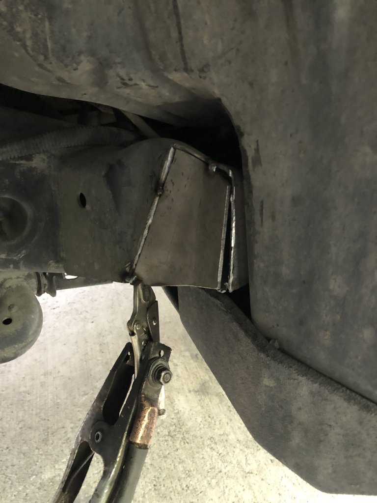

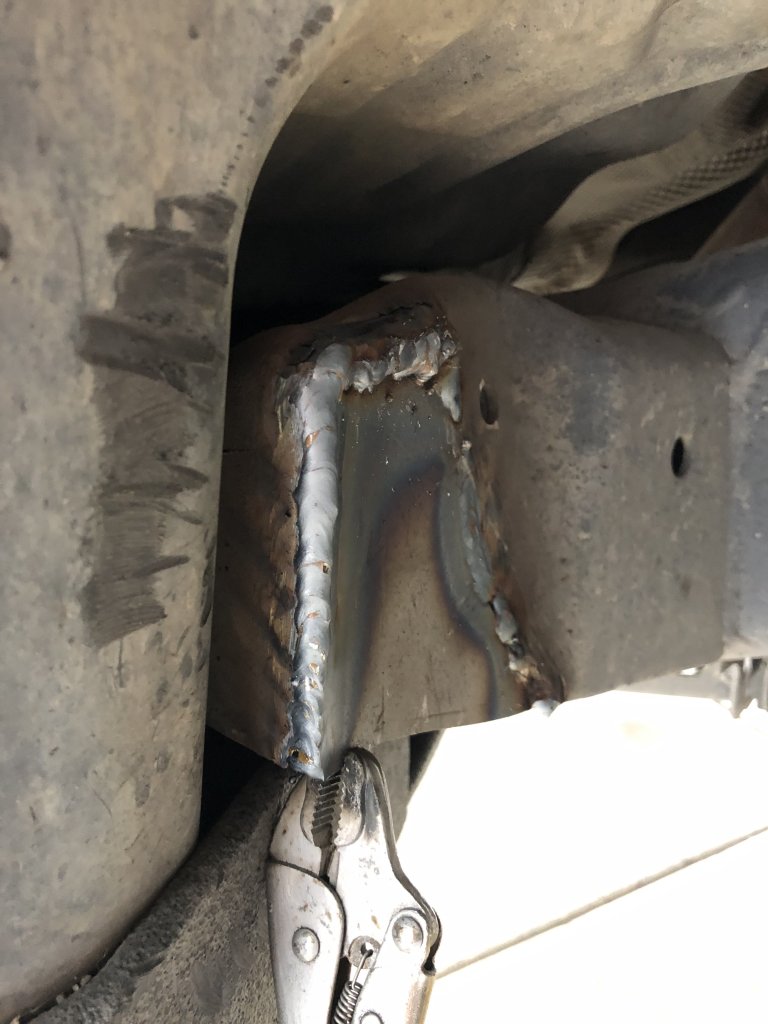

Howdy, can you shed some like on how you trimmed the frame horns? Did you need to weld a new flat piece back on after cutting?
That’s up to you. It’s purpose is to divert energy (and the truck) in a crash outward and away from the impact in a frontal offset collision.

Here are some pictures of the frame horns being trimmed.

I’m thinking you shouldn’t pay more than $225. I paid $150, but I did help with the job a little bit.
