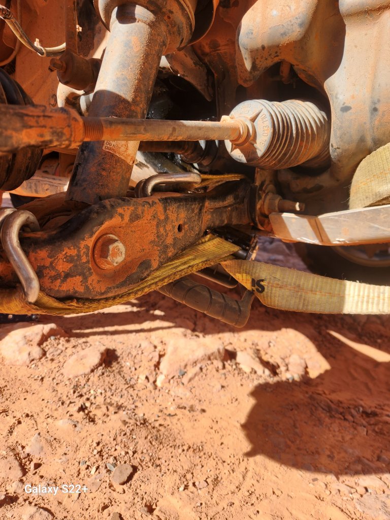

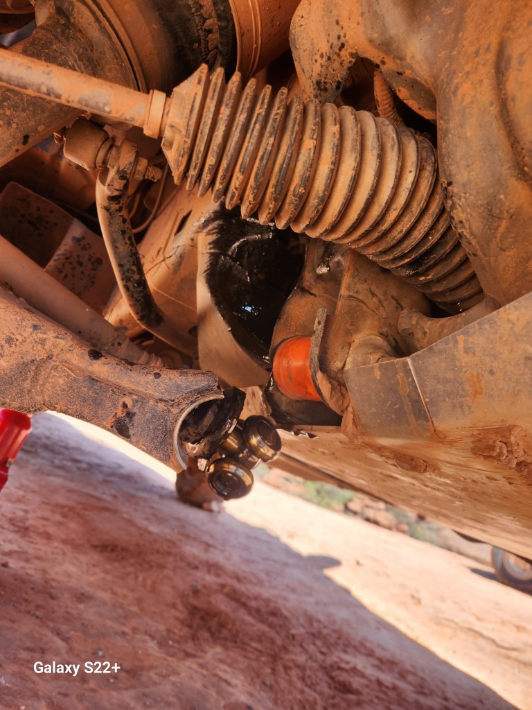

OK - I'm sold on adding armor!! What was the cause of your suspension failure. I am going to tap into the air line on all four corners and splice in a schrader valve to fill the air suspension in the event of mishap.
My front LCA snapped at the poly bushing, pulled the axle out of the cv joint, and pinched the air strut.
HD ratchet strap tied down to limp out of the trail.
I always carry tools, but will be adding some more. Luckily, there was an O'Reillys a mile away for me to do this at our AirBnB. Not sure if you can see, but the air strut is bent and yhe LCA broke.
1,420
What brand LCA? Do you think the poly contributed to the failure? That is a hefty field repair. They had an air spring at an O Reilly's?

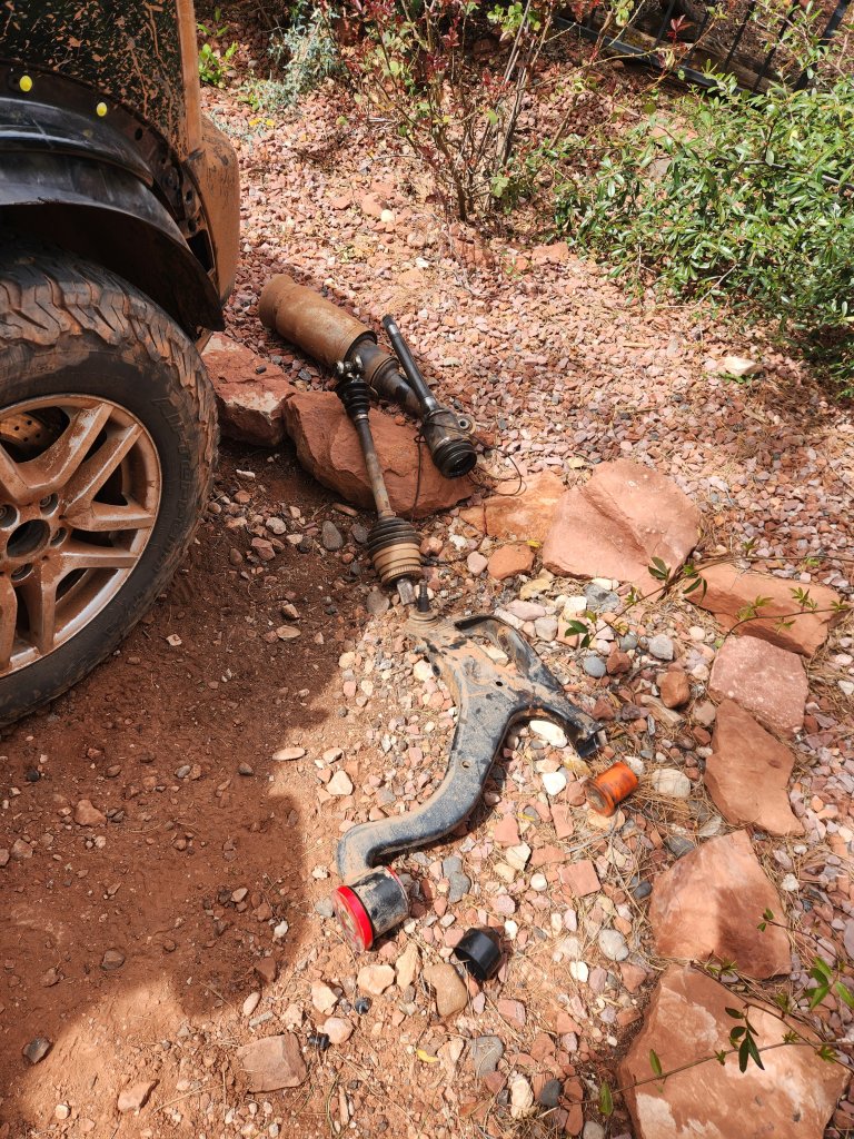

It was the Lucky8 HD LCA. I'm 100% sure it was the poly that caused it. The polys don't flex too much or at all, and diverts the stress points to somewhere else. Which happens to be the LCA bushing bracket. I've put my truck through a lot of harsh trails, but I don't abuse it. It finally gave out on the easiest trail (Soldier's Pass) in Sedona, AZ.
As for the parts, I reached out to a buddy in San Diego and he started a chat with some AZ locals. A buddy sourced the parts (Arnott air strut, Duralast Axle, and Duralast LCA) that night, and another buddy drove 2 hours up from Phoenix, AZ the next morning at 6:30 am. I took 2 hours to rip most of it out at night in 40°F pitch darknest except for a headlamp. Next morning it was 33°F and it took 3-4 hours to get everything in right before we had to check out of our AirBnB. The key was to mark your alignment prior to dismantling, it was straight enough to drive 1000 miles to finish the rest of the trip.

this ^^ is why many of us recommend the Meyle HD lower control arms. They have rubber bushings that are soft and similar to the OE hydro bushes, but they are tougher than the hydro bushes and won't leak their fluid after a couple days on the trail. (riding trail with the bushing knock sucks.. haha)
I've beat the snot out of my Meyle arms and they are great. I wasn't able to tell any difference from the OE ones.
