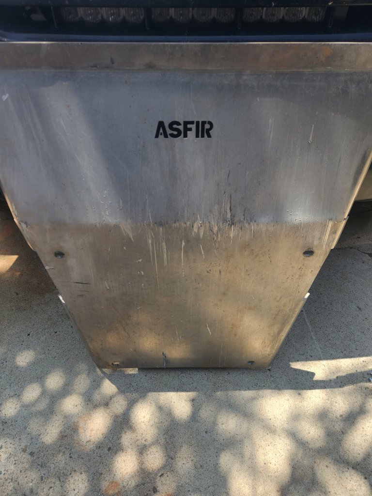

Here's why you want underbody armor. Sometimes on THE most basic trail, ship happens. You're limping off the trail with a busted air shock and an axle barely hanging in the cv joint to get you moving, you'll be glad to have some protection.
This is in limp mode with the SYA kit.
The damage with deep gouges.
This time I was somewhat prepared compared to my first outing and limped a mile out of a trail and home on bump stops.
Just sharing my experience for those that think under armor is a waste of $$, because rock crawling isn't on the their agenda.
