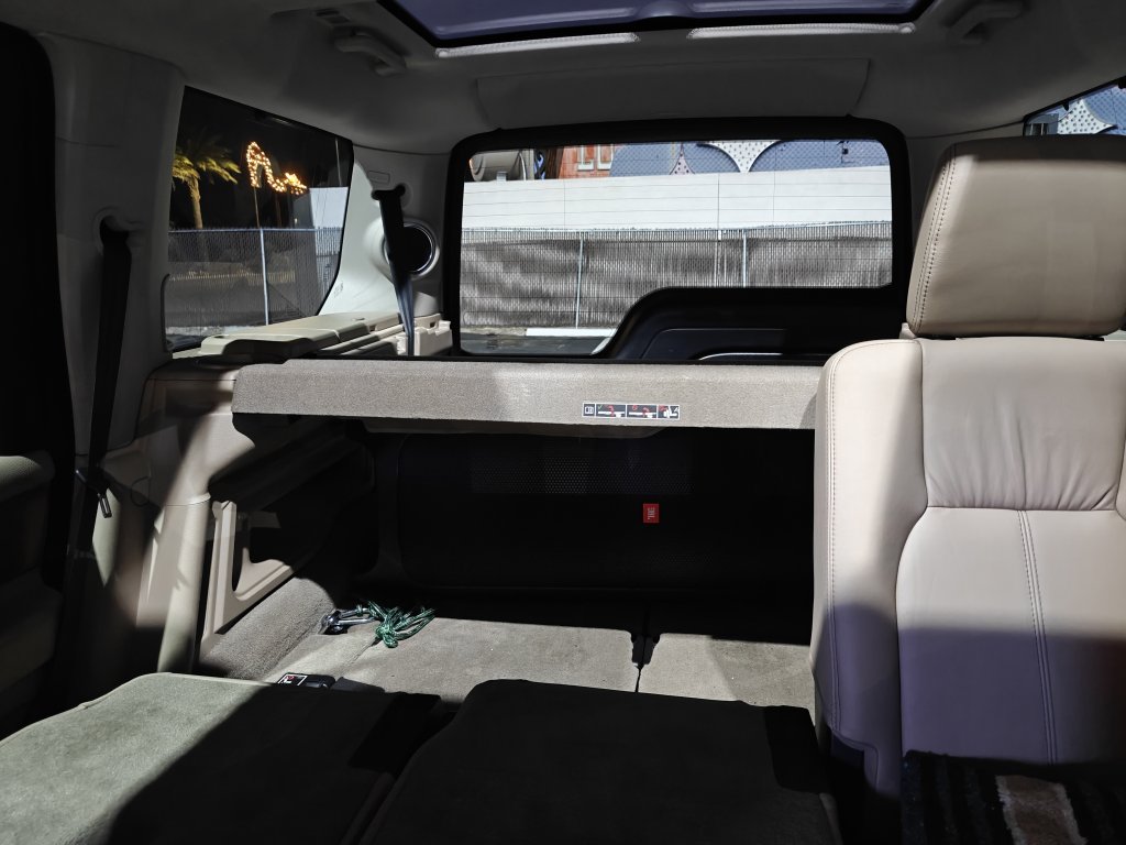

JBL came out with a PartyBox Ultimate with 2 9" drivers, 4.5" mids and a tweeter and I was thinking about getting it but saw the Partybox 1000 that has a 12" subwoofer, 2 7" mids and a tweeter. Both stream over bluetooth and the Ultimate does Wifi with major exceptions and terrible compatibility so I bought the Partybox 1000.
Its 87 lbs on wheels and it has similarities to the PartyBox 310 in the OP, but it requires the entire horizontal space in the back at about 42". It also requires a power cord and the PartyBox 310 has its own battery. The 1000 finally arrived yesterday and I rigged up an inverter to try it out and holy **** there is a lot of bass in some songs. Playing back Pink Floyd Mother vibrates the entire cabin. The seats vibrate, my chest vibrates and the Radio Shack decible meter measured 120db. The LR4 sound deadening constantly impresses. I step out of the cab, shut the door and can barely hear the music from outside.
The PartyBox is returnable with free shipping and I might return it because at low volumes its not that great and the bass is a little muddy. Then if I want to pull it out the cord needs to go with it, which might not be an issue with an extension cord that way I can jam while washing the LR4.
I might try going to a stereo shop and asking them what components I'd need to get the same bass levels with the factory unit. Then price that out and bump it up a few notches because that bass is deeply satisfying. I don't want to lose my hearing over it though lol. I'm not sure if I can get deep bass at a lower decible. I know with home audiophile grade equipment there isn't a need to go that high to get deep bass and good sound. More like 85 db is about right.
