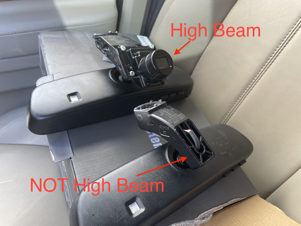

Both headlights work fine. High beam, low beam, auto turn on and auto turn off works correctly.
The only other CCF setting seem to be:
Auto High Beam 1: fitted
Auto high beam 2: enabled
Auto high beam 3 Current: North America

Auto High Beam is not for Adaptive headlights, it's just high beam and depend on your interior mirror:
For Adaptive Headlights you need that:
-Adaptive front lighting system = Fitted OR Not fitted
-Headlights, type = Advanced front lighting system with adjuster OR Gas discharge lights with auto adjuster

Yes I agree on adaptive vs automatic.
I’m looking for other settings I could change
I’m not seeing Headlight type with adjuster or gas discharge lights with adaptive
