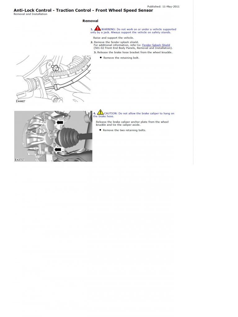

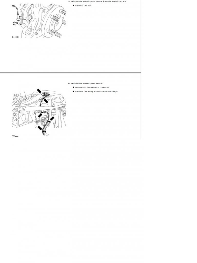

update
I found the
following stuff
218,151
