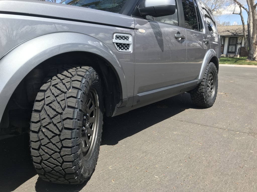

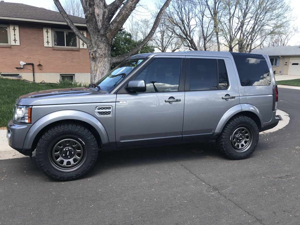

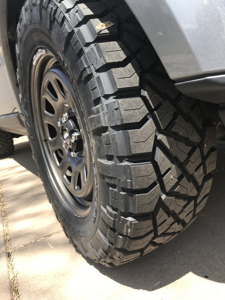

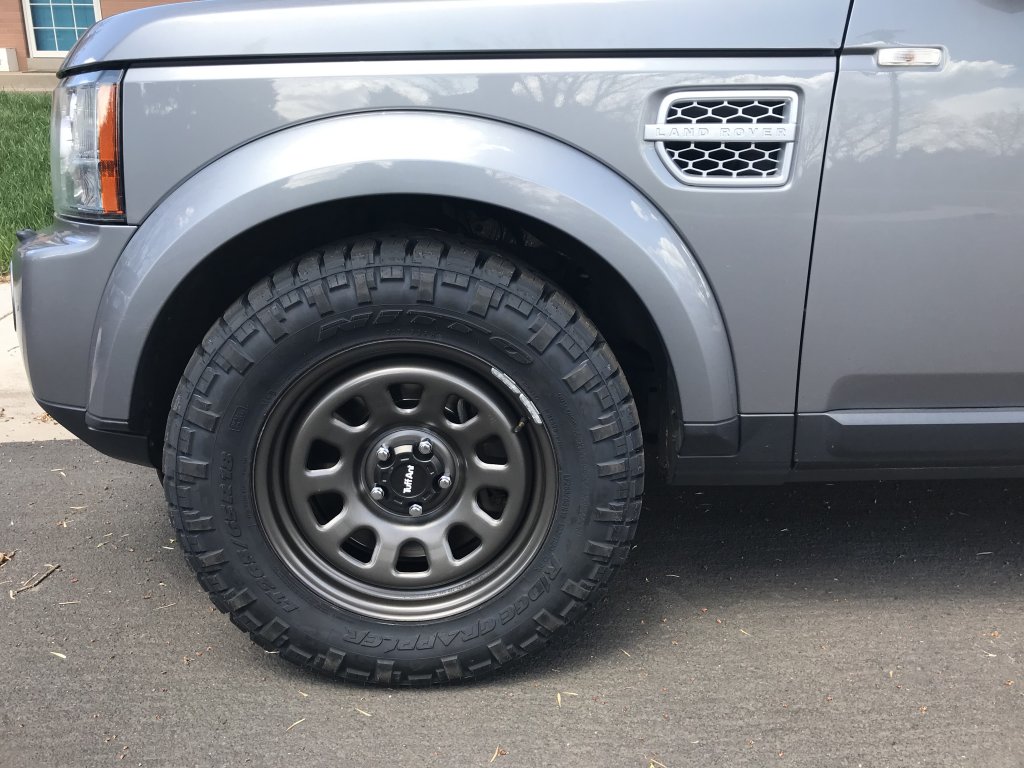

I just mounted 265/65 18 with Nitto Ridge Grapplers and due to being 0.26” larger than KO2’s I needed some minor wheel well mods (shave frame horns on backside of front axles, tie left front wires higher and heat press bumps in plastic liner but did not need to modify rear heater lines like others who run larger tyres). They run quiet on the road and I anticipate they will perform well off road too but haven’t had time yet. Love both wheels and tyres :)
I plan to run toyo observe snow tyres on my 19” rims so am not concerned about snow performance on these.
The charcoal color is great but not sure if it matches OP’s bronze truck. It barely matches the grey paint but I like it better than black which is so common. Oh, and I did need wheel straps (F150 style) for TPMS. Bought those on Amazon. Spare tyre need to be at 5 psi to fit in spare area with heat shield removed, and it takes some wiggling but it isn’t so tight that it gets stuck but you do need to wiggle it out.
