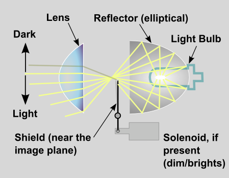

In the 2014+, there is only a bi-Xenon lamp where the reflector moves (no halogen high-beam)..
This is correct. "Bi-Xenon" does not mean two separate Xenon burners. There is only one, with a shield that blocks part of the beam, so it is "low beam". Switching to high beam just moves the shield and changes the beam pattern to "high beam".

I think different people may be using the term "bi-xenon" differently in this thread.
I have a 2012 with the HID headlamps. The Xenon burner has a moving reflector/shield. When I turn on the high beam, the shield/reflector on the Xenon lamp moves to give a higher cutoff, AND a separate halogen high-beam turns on.

The attached jpg shows the movable shield referred to above that moves out of the way when high beam is called for. That then means you have high beam as well as low beam coming from the single Xenon bulb.
The bi-xenon shield setup is not a good design for "flash to pass", hence we have the separate halogens for that function and to provide additional illumination for high beam. It is a pretty good set up and not something I would fool around with too much.
To see how all works, park in front of a reflective window at a shopping centre and play with the high and low beams and flash to pass.
