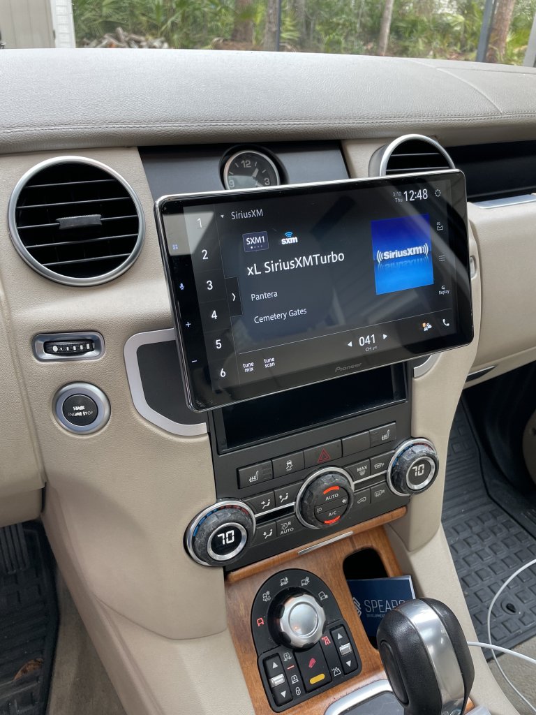

I keep meaning to post this, but I just did this a couple of weeks ago. I’m pretty sure I’m the first one in the country or world with a single din floating unit on a LR4. 2 weeks after asking Spiral Audio if they had a single din kit, it magically appeared on their website, and I jumped on it. Now I’m rocking a 9” Pioneer floating head unit!

Would be kinda cool to get the single-din and have a pop out touchscreen unit. I'd get rid of the clock by tucking it under one of the center vents and put a dual row 12 gang rocker switch panel there.
